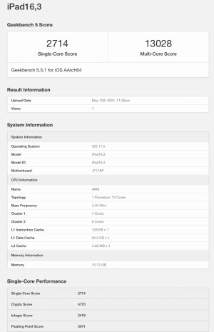

If you tested with GB5, you would probably get a more grounded comparison to M3 (or other CPUs).
This is the highest GB5 score I found so far.
SC: 2641.
M4 is probably the fastest CPU for now. I know the Core i9s will the e cores disabled will score in the 3000s in GB5 but I consider stock scores considering the M4 you know doesn’t guzzle power.
It’s massive feat considering Intels nor AMD CPUs can’t manage that single core in laptops or tablets.
You need a desktop i9 to get to M4 levels.
Regarding SME, since Apple using an industry standard ARM extension and the world is an AI craze right now, I wouldn’t be surprised if ARM vendors also start supporting SME soon.
Edit: there’s still so much we don’t know about about M4. It’s PPW and it’s area.

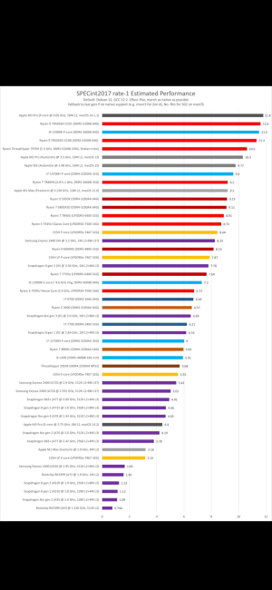

Also here SPEC. A bit older but you can probably speculate where Intel and Apple lie in for M4 Max and Arrow Lake.
