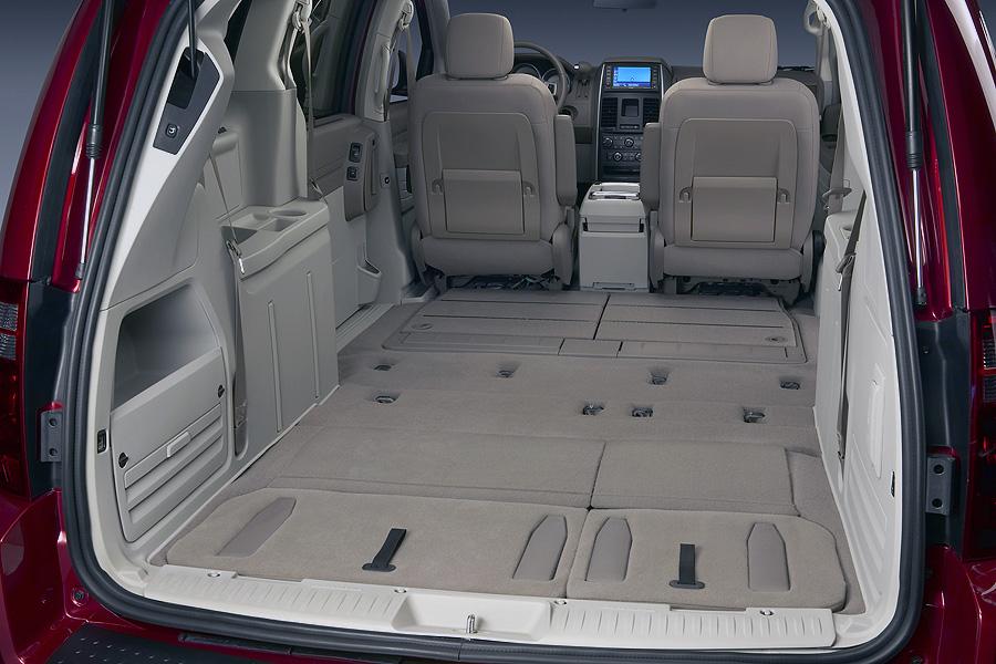

I'd buy a used Pentastar equipped Grand Caravan with Stow and Go or remove all rear seats for a flat floor. It will be a comfortable travel cruiser, much more so than a Chevy Express.
If you remove the seats, you can then use the stow and go space for more cargo
I'd then customize with creating a two layer storage system with custom shelves. I'd put all non-living cargo on the floor and then put the crates on the 2nd level
