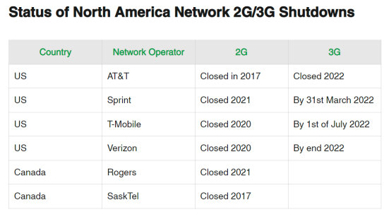

main-qimg-46398371b6bf5816345cb34d6e777471-lq
In the case of people reporting no signal w/in one block of their location... It could be a dead zone that's not covered or the carrier turned down lower frequencies to make room for LTE/5G which dropped the coverage of prior signals. 2G/3G signals have been turned off for the majority of areas in the US at this point which could be why you're seeing the lack of signal now.
  1. Reuse of frequencies for new technology deployments like 4G and 5G. Most 2G use 850, 900, 1,800 or 1,900 MHz frequency bands. The sub-1 GHz bands, are very valuable due to their propagation characteristics, especially delivering greater coverage and in-building penetration.

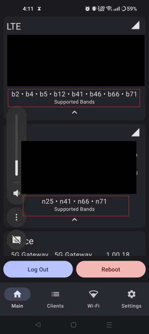

So, looking at that for the frequencies you'll see overlap of services in use now that use those bands like FWA.
https://en.wikipedia.org/wiki/5G_NR_frequency_bands - n bands
https://en.wikipedia.org/wiki/LTE_frequency_bands - B bands
So, the x71 is the 600mhz low band that gives you distance but lacks in bandwidth. In my case and testing of exclusively connecting to this band resulted in mediocre speeds of 50-100mbps. Pulling back and switching to other bands such as n41 though bumps those speeds to 600/100. It all depends on how the carrier sets up the site though and which frequency blocks they have in that market and the allotment of spectrum to use. The allotment could be anywhere from 5-100mhz and each yields X/mbps in terms of bandwidth. This also has to take into account the number of users for a particular site as each chunk of spectrum only supports X users. As you add more users the distance of the RF typically shrinks as well to compensate for the load. If you test your speeds during different times of the day you'll notice that less peak times will come back with better speeds.
With the way that 5G works though currently you need to tether it to a 4G signal and piggy back off that to setup the data link. Using different signal monitoring apps you can pinpoint which ones are surrounding you and figure out which carrier might be the best option for your specific locations.
