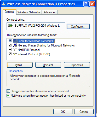

Log to Windows Control Panel, click on the Wireless Network Connection, Right click on the connection Icon and choose Properties, click Wireless Networks.
You should see this Screen, http://www.ezlan.net/network/Wireless1.jpg
Check the two boxes at the button.

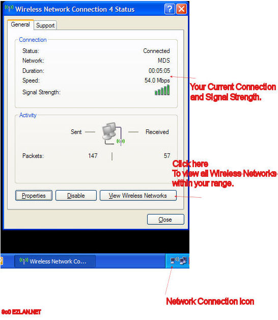

Close the Opened Windows and double click on the Network Tray Bar Icon.
You should see this, http://www.ezlan.net/network/Wireless2.jpg

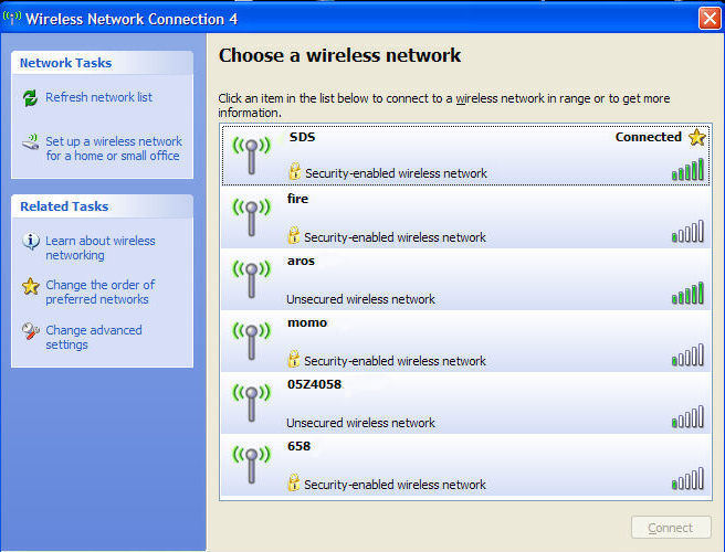

Click on View available Network.
You should see this, http://www.ezlan.net/network/Wireless3.jpg
It shows you all the Networks around and which one you are connected to.
