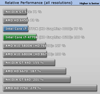

With the launch of haswell intel is now in a very strong place regarding its igps.
On mobile hd 4600 appears to be in a position where it can compete with trinity on a fairly even footing.

This compares the a10-4600m to the i7-4930MX. The two are relatively equal with the hd 4600 leading at lower resolutions and trinity leading at higher resolutions. Note that lower resolutions tend to matter more because many games are not playable at higher settings (intel seems to optimize their drivers for low resolutions and settings and fps tends to drop off when settings are cranked up). However, the 4930mx runs at 1350mhz, significantly faster than is expected for the i5 and i3 level hd 4600 igp. At a speed of 1150 mhz (expected for i3/i5 haswell given the speed for ivy bridge where i5 runs at 1200 mhz and i3 at 1100 mhz) and slightly less cache I expect the hd4600 to run about 10% slower than the i7-4930mx and about 12% behind the a10-4600m. Notebook acknowledges that there are testing inconsistencies in their review and looking at the Tom's review we can see that the hd4600 generally performs much better in comparison (testing the i7-4770k with its gpu at 1250 mhz) possibly because of throttling on the mobile chips (?).

In conclusion it can be seen that as the settings are turned up amd's lead over intel tends to grow (vs toms hardware). Expect given these numbers that mobile haswell will be very close to trinity given the fact that mobile haswell will have slightly lower clocks and less cache. It can also be seen that perhaps (need to isolate variables to be sure) faster RAM helps trinity more than haswell. On average trinity a10-5800k is about 30% faster than haswell. HD 4600 is about 30% faster than HD 4000.

So it looks like HD 4600 in i5/i3 mobile will be about as powerful as trinity (looking at in the AT tests the 4600 in the 4770k is about 10-15% faster than the 7660G) and about 10-15% behind the top level richland chips. On the desktop the a10-6800k is about 10% faster cpu wise (4.4 vs 4.0 ghz) and about 5% faster gpu wise (844 vs 800 mhz). Mobile will be very close but in desktop richland is still going to be about 35-40% faster than your average HD 4600 chip.
As can be seen trinity/richland is around 30% faster than HD 4600. Richland is essentially indistinguishable from trinity (2% gain).
