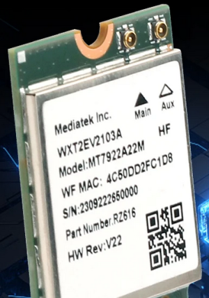

I bought an M2 wifi card and an antenna+cable off a different person.
I can't get the cable to connect and I'm beginning to support they are mismatched.
This is the card:

Do they look like they should fit together?

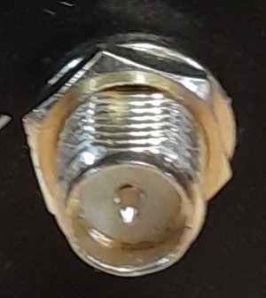

This is the antenna connection:
If not, what kind of wire should I order?

M2 cards are mhf4 and the other end is up to what you want to use for antennas. Typically wifi is rp-sma with the pin.
Putting the mhf connection on the card can take a few tries. I tend to line up the cable to catch on the edge of the connector and then apply pressure to get it to click. They are finicky and delicate to deal with. The older mhf1 connectors being slightly bigger were easier to deal with but still a pain.
