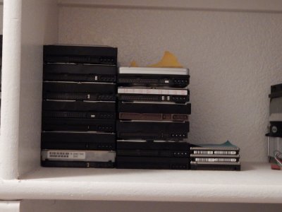

Well out of 13 - 3.5" drives, four had data on them, none that I wanted to keep. Funnily, three of those had my post-it notes indicating they were empty/formatted. lol I don't know what happened there maybe I meant 'ready' to format. The eldest drive was a Quantum Fireball 4.3GB that squealed so loudly when powered up that it startled me (and the dog), like the bearing was going to seize up. But went quiet after about three seconds and worked fine, enough for me to check it out.
The stash of IDE/PATA (ignore the 2.5" photobombers):
I'm keeping five (no more!) of the newest drives > 60GB. The rest are going to ewaste. Never did get around to using the HighPoint card. I just used the mobo ports.
