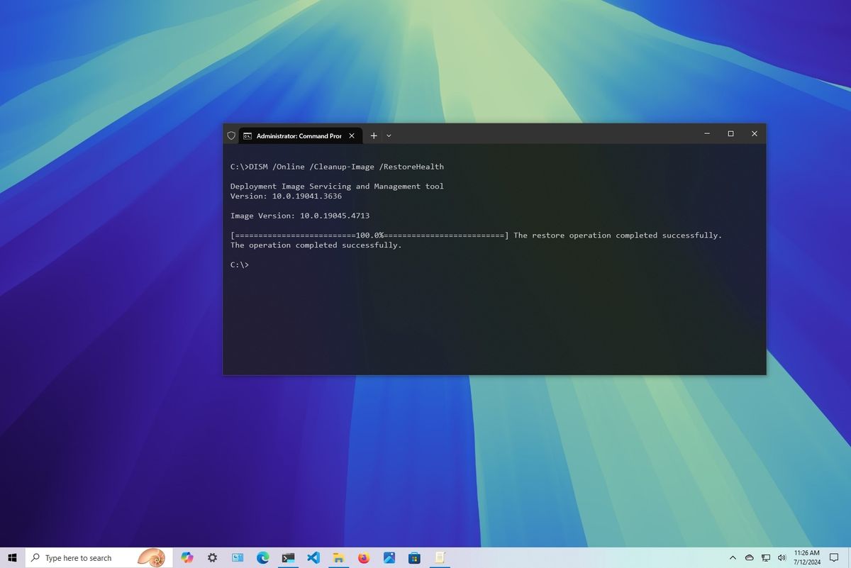

What hardware components make up your system? I'm presuming that you have run the standard checks like SFC /scannow, a file system check and a DISM health check?

SFC and memory tests always pass. I didn't know about DISM. Should I try that using the instructions here

I don't think I'd bother with DISM if SFC isn't finding errors and the memory subsystem tests are passing.
