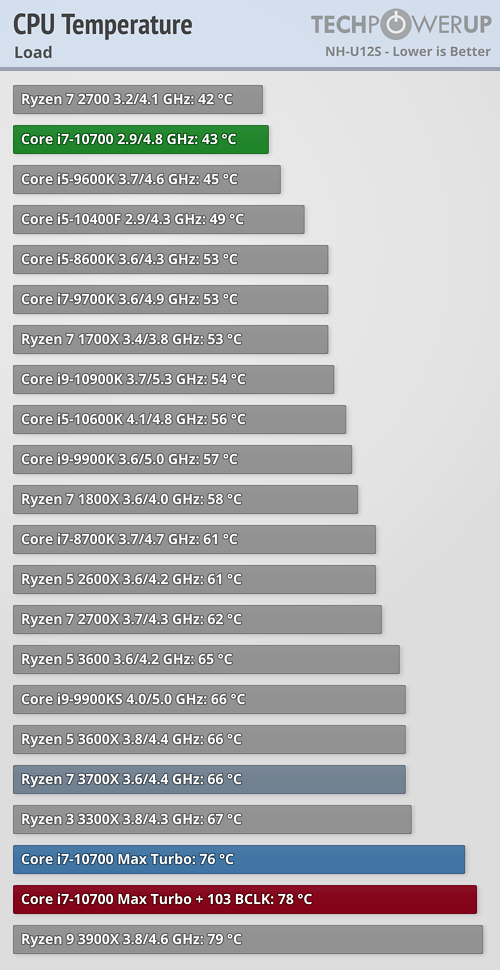

Something is not right if your temps are that high at stock. I imagine that the motherboard is not set to the Intel spec (PL1).
Things are different once you start unlocking the power limit. Intel intended for the Core i7-10700 to operate at 65 W, which is simply way too low for this 8-core/16-thread processor. In order to achieve their 65 W TDP promise, Intel has set the PL1 power limit to 65 W. For short, in bursty workloads the PL2 power limit will override PL1 for a few seconds as it is set at a generous 224 W.
In the review, they use a Noctua NH-U14S and run Blender. With the 65w limit enforced, they were only at 43c. However, enable PL2 and it hit 76c:
