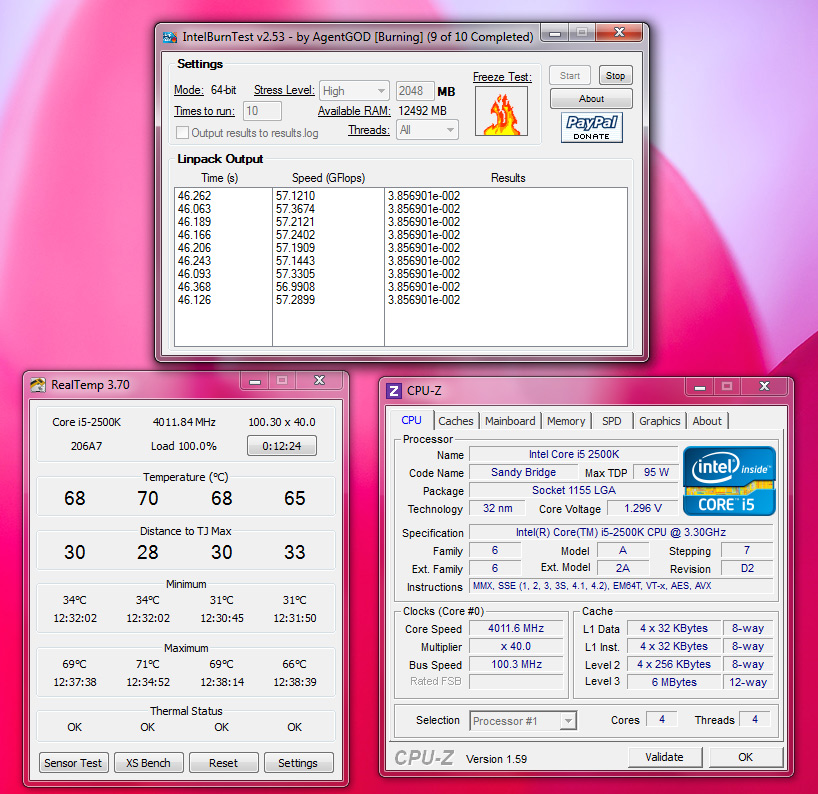

So, I'm quite new to overclocking of this sort, that is, on a chip that dynamically changes speeds and voltages and such. I have overclocked chips for years, though always a mild OC due to chip life concerns...I've overclocked a Pentium 166, Athlon XP, Athlon 64 and Core 2 Duo (though eventually went back to stock due to stability problems after about 2 years).
I always try to stick to stock voltage. I was going to leave my 2500K at stock, but considering most people are easily getting 4.3 GHz, and most are getting 4.5+ with a little effort, I thought I'd try and jump it up to 4.0 GHz. I'm less concerned with shortening chip life with this processor than in the past, mainly because for 90% of its life, it'll be at 1.6GHz and 0.85V. 🙂 Still, I don't think I'll go beyond 4.0 for now. That's plenty of speed, though if I start feeling like it's bogging down I might bump it up in a year or two (I usually keep my rigs for about 3 years, though I had my Core 2 Duo machine for 4.5 years....)
So, I just changed the multiplier to 40 in my BIOS and did absolutely nothing else (aside from running my RAM at the rated 1600MHz). So, voltage is set to auto (and lists 1.335V as default).
4.0 Seems very stable so far....ran an Intel Burn test at High with no issues, and Temps are at 71C absolute peak on one of the four cores, with the rest of the cores in the high 60s. CPUID is showing 1.29V (occasionally jumping to 1.308V) when at load. I'm using a CoolerMaster TX3 with two fans (can't fit a larger heatsink).
Do you think this looks good? Temps good (it's cooler than with the Intel HSF at stock speeds)? Should I just leave voltage as is, or can I even back it off a bit? If I do, would there be any real benefit?
Here's the temps/processor info during run 10 of IBT:
Backing the core voltage down helped to reduce temps, in my case approx 8-10C. Higher than required voltage and heat are not your CPU's buddies, it wouldn't hurt to go in and just reduce voltage a little and see how stable you are... I dropped mine .007v and that's where I'm at now with a 41x multiplier. Safe and stable.
u can get faster than that with less voltage just so u know. i have 4.4 at 1.276 vcore and my temps are much lower are u using the stock cooler? try switching to offset mode and doing -.010 and see if that lowers temps and if u stay stable
Ok...Changed to -0.010, now running at 1.284V at full load. Temps seem about the same, maybe 1C lower (Intel Burn is peaking at 70C, while operating at 68-69C most of the time.
This is with a CoolerMaster TX3. Stock Intel HSF is nowhere near this cool, so you know...I was hitting 76C on stock cooling at 3.3GHz, and 82C on stock cooling at 3.6GHz. At 4, I'd imagine the stock cooler would run around 85-88C.

Anyway, I'm stable right now at 1.272V, though no real impact on temperatures.
I guess the big question I have, since I am not planning on overclocking higher, is: Is this safe for 24/7 running (especially since under normal loads I almost never break 60C), and since with the intel stock cooler I was running at 75C load and a slightly higher voltage, am I actually going to have better than stock lifetime at 4GHz, 1.272V and 70C absolute peak temperature vs 3.3GHz, 1.29V and 75C load temps?
I get 4.3 GHz at 1.24v max load voltage. That's with LLC 2 and -.04v offset (I think).
You should try some lower voltage to see if it's still stable.
Yeah, I'm working through the lower voltages now. At 1.26 right now (-.03 offset), and it's working fine. That dropped temps by about 2C, so I'm peaking at 69C now on the hottest core, though it's typically running at 68. Average across all 4 cores is now 65C. I'll keep going lower....
Ok, so when I rebooted at -.03, instead of rebooting, it shut off. Then it wouldn't come on again, so I turned off the power supply, hit power and booted, didn't think much of it, and dropped to -.04. It booted fine, ran IBT for a while and was fine. I wanted to just check rebooting, so I did, and then the OS failed to load...hung on boot. So I hit reset, and it went into a power cycle loop...fans would spin up for two seconds, then shut off, over and over, until I shut off the power supply again and waited a second. When I got back to BIOS, I went back to -.02. 🙂
Now I'm going to run Prime95 for a while to make sure at -.02 it's stable. At -.04, when running IBT, it was at 67C, with peaks of 68, average of 64. Still, having a computer that fails to boot every so often is not so good. 😉
If I don't go higher, are these temps OK?

Your temps are very high for a 4ghz OC. Yes 70C isn't bad in the grand scheme of things and if you were at 4.2-4.4 it would be about right but you should (depending on your chip) be able to lower the voltage further and still stay stable. Keep nibbling at that vcore and testing until you find it becomes unstable then bump it back up a tick or 2.
For a point of reference my chip (which isn't a golden sample by a long shot) will happily hit 4ghz just under 1.2v.

So, I've been running P95 for a while now at 1.272V, and it seems fine. Reboots at this level seem fine too, so I'll probably keep it there, since the issues started at around 1.26V. So, I know this may not be the coolest rig in the world, but am I correct that there should be no long term issues with these temps and this voltage?
Am I correct that:
4GHz, 1.272V, 34C idle, 69C IBT max, 61C 3DMark is better than:
3.3GHz, 1.296V, 36C idle, 76C IBT max, 72C 3DMark (fully stock: what I was getting when I first built the machine with the stock Intel HSF).
Or, does the higher clock speed negate the lower voltage and temperature for the long haul? (Most people have said that voltage is what reduces lifespan, rather than clock speed.)
Ultimately, 4GHz is more for 'hey, I've got a 4GHz chip' than for any real need for the extra speed (though a little extra speed is nice). I just need the chip to last a fair amount of time and be very stable.

Your cpu has an internal lookup table that specifies what voltage it requires at any given speed. If it is asking for 1.296 @4ghz it is probably close to the 1.22v I saw @ stock when running at 3.3.
I decided to see if I can replicate some of your numbers so I set my CPU multi at 40 set LLC to medium and dialed in -0.7v offset voltage. I am just about to finish a 20 run very high intel burn test and my max temps for my cores in CPUID HW monitor are recorded as 51C 53C 56C 54C (it is pretty warm in here tonight aswell thank to the Mrs having the heating on high). Max voltage showing in HW moniotor is 1.25v and i'm certain I can get lower than this stable lowering the temps even further. My cooling setup might be a bit better than yours but can you see why people were commenting on your temps being a little high....

I highly doubt you are going to hurt the cpu with those temps and voltages. I was just showing you what a similar (I know my components are a bit different) system can achieve to see if you could push the voltage down a bit more. Is it possible to add another case fan or 2, or are all the fan bays filled and are you sure the TIM is applied correctly and the cooler is fastened down correctly. Also you could adjust the fan profile which might shave a few degrees off peak temps.
Once more, I am not saying you are running too hot just that it might be possible to run cooler which will prolong the life of your chip and keep things quieter.
