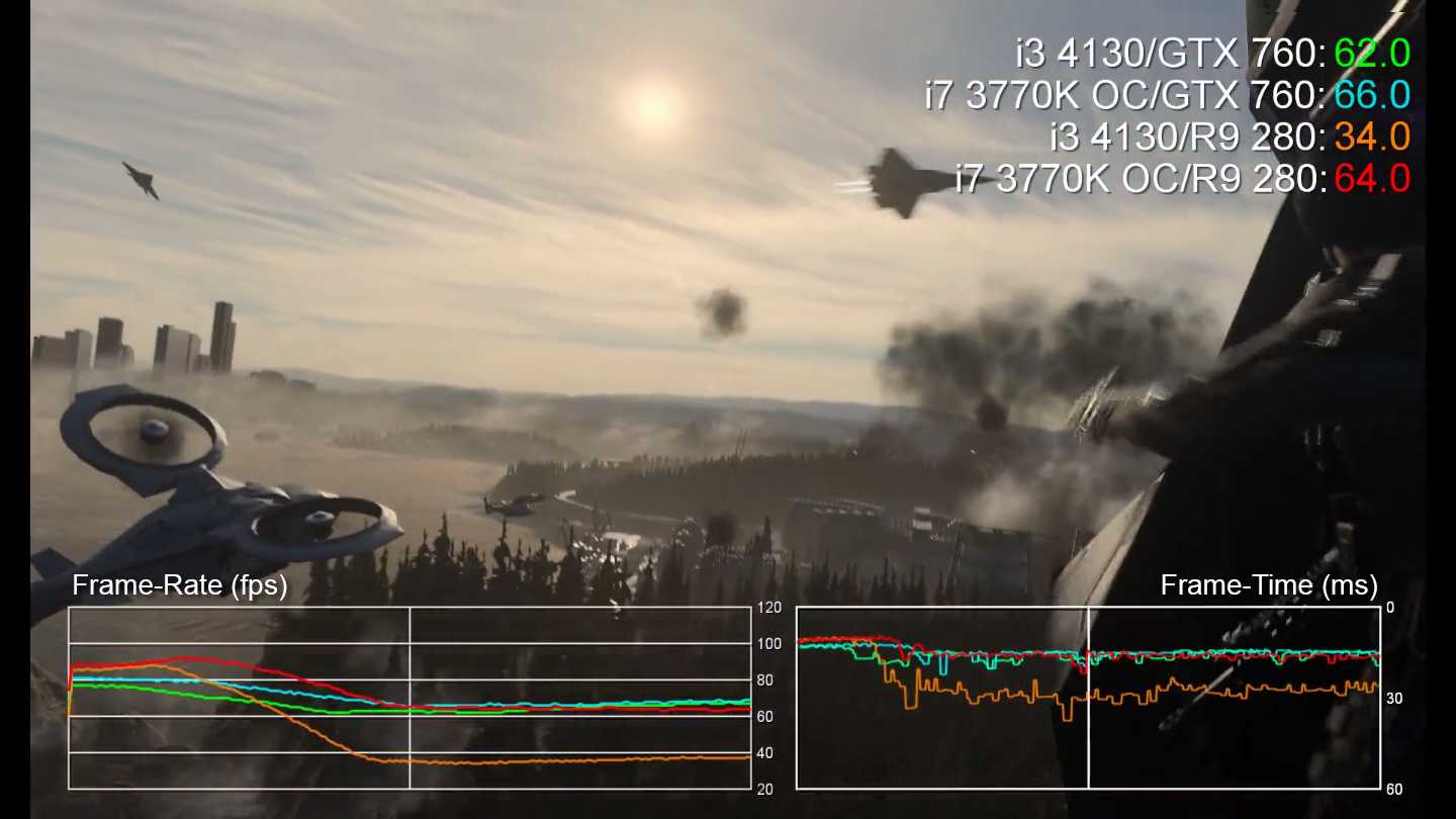

my i3 2100 can't handle well enough quite a few single player games, but looking at stuff like this
having an AMD graphics card is probably one big factor
Didn't realize the penalty could be that bad with an AMD GPU. Is that test with or without Mantle?
Wow, what's the story there? Looks like a Eurogamer.net review, but I can't seem to find it. That result with an i3 looks pretty awful.
Oh okay, I found the review that screenshot is from: COD Advanced Warfare on Eurogamer.net. According to them AMD cards at the R9 270 level and above don't play nice with i3s, though the GTX 760 gets spectacular results:
Eurogamer.net said:
http://www.eurogamer.net/articles/digitalfoundry-2014-call-of-duty-advanced-warfare-face-off
However, we can report that we see the same issue to different degrees on other AMD GPUs too, though the lower down the stack you go, the less noticeable the impact (as you're hitting GPU, rather than CPU limitations) - as we saw when testing with an R7 265, essentially an overclocked version of the classic Radeon HD 7850. Generally speaking though, if you're running anything at the R9 270 level or better, we'd recommend an Intel quad-core processor or the equivalent for best performance with an AMD card, while a Core i3 is potent enough to deal with Nvidia equivalents in this performance range.
