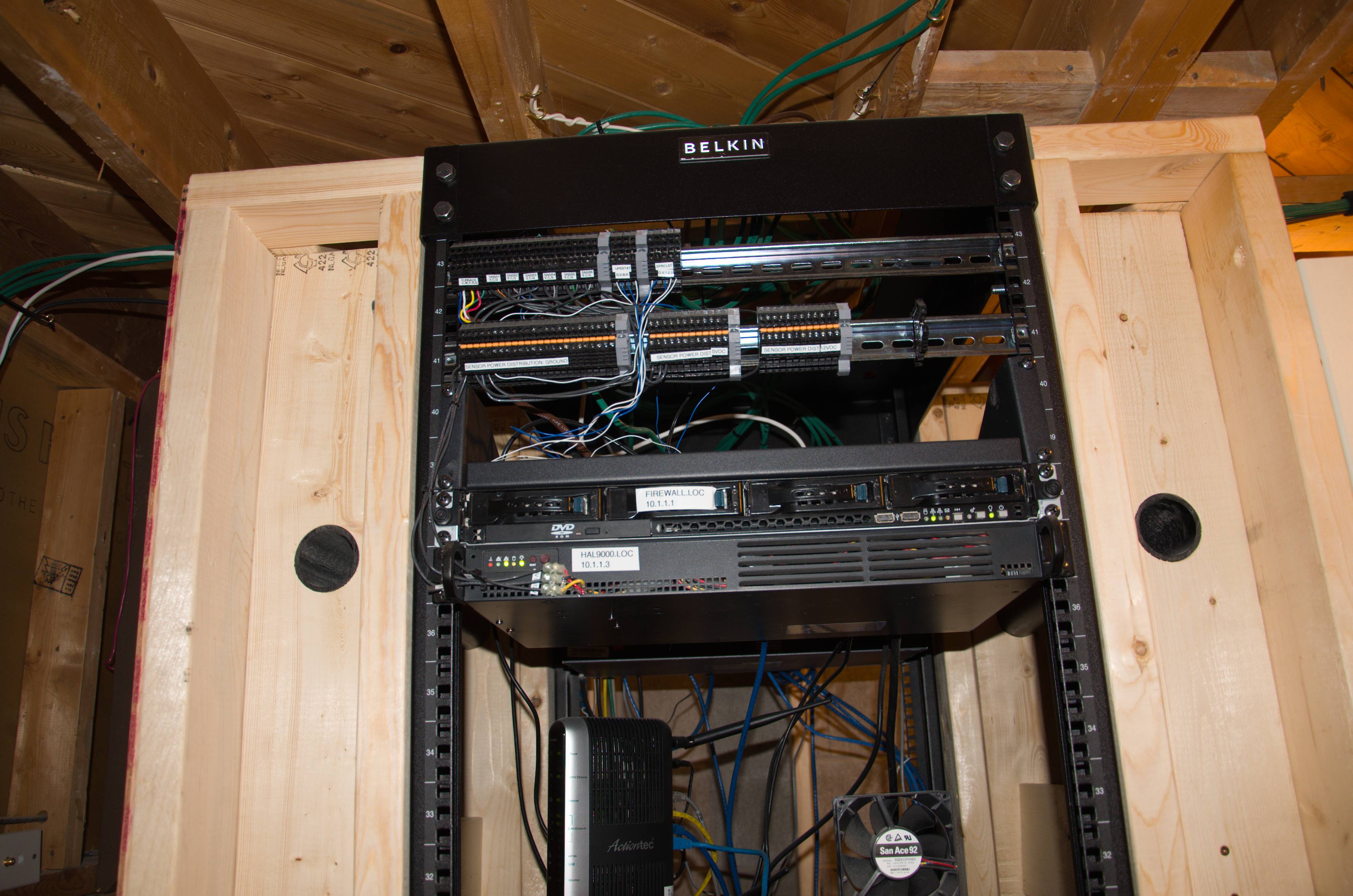

Yeah it sounds like a pain in the ass. I rather something you have full control over. When I started researching the components to build mine the nest had just come out, but I opted to go with my solution anyway. If I was to do it over again I would have gone Arduino though, but it works pretty much the same way as it's the server app that does most of the work anyway.
