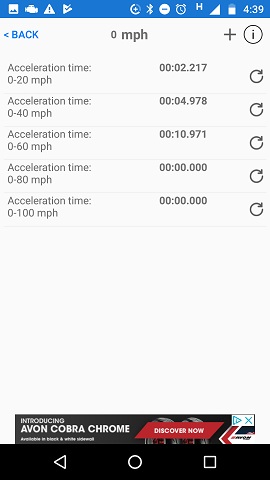

A few minor modifications later, the HCH transmission is installed in my Insight. It's now only a little over 3000rpm in first to get to 2000rpm in second. I can use second gear between 10-18mph without lagging the engine. Acceleration is improved in all gear and feel way more than 12% as the FD ratio suggest. The car can climb small incline in 5th gear now on highway! It requires way less downshift just to maintain speed. My IMAless gas Insight actually feel FUN to drive!
