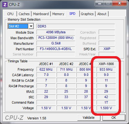

If only one stick gives errors it might not be a compatibility issue at all. Pulling out a module, test and switch, shouldn't be too much of a hassle.
Before you mess with timings, you should be able to set a different profile. CPU-Z shows the various available profiles in the SPD tab. Random image:

Are you saying that the CPU-Z will ID the RAM and indicate back the timings that should be set in the BIOS?
Yes, you'll see the numbers for the different profiles. I'm pretty sure that it's 10-10-10-30 and 1.5V for your DIMMs but that's the tightest XMP profile.
If I disable XMP on my board and select Auto, my bios sets much looser values like 12-12-12-39 say.
To get a CPU overclock stable I have to set looser timings in this simple manner, by disabling XMP profile and setting it on [Auto].
Because timing and frequency are linked, you can also try simply lowering RAM frequency to 1333 MHZ (667) or 1600 MHz (800). Intel Celerons and Pentiums only "officially" support 1333MHz for instance. Perhaps this will get your instability sorted, but it may be just faulty RAM. If anything it's good that you noticed this early.
I wonder if I'll get memtest errors if I set known unstable settings, maybe something I should test.
