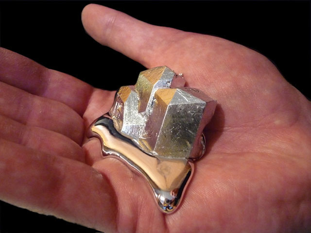

I just got 20 grams of gallium
If you get enough gallium, you could conceivably use aluminum as the "fuel" to keep your house warm in the winter. Gallium + aluminum, then + water = hydrogen (burn for heat) + aluminum oxide, plus you get your gallium back.
