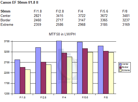

You're saying the 1.4 has worse corner sharpness than the 1.8? o_O
From my experience, yes. It was horrendous.
Here are a couple MTF charts from Photozone.de:
50mm f/1.8
50mm f/1.4
From my experience, Canon's 50mm f/1.4 was very *mediocre.* Nothing less, nothing more. Focusing speed and accuracy were only decent, build quality was only decent, barrel distortion present, horrendous corner IQ at large apertures.
50mm f/1.8
50mm f/1.4

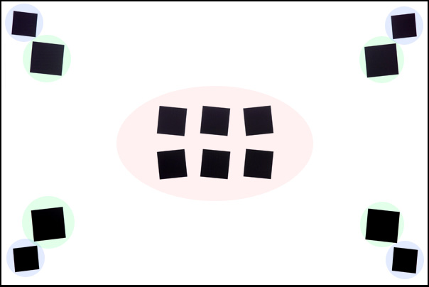

The number on the left of those graphs. What do they represent?
Q: What is the meaning of LW/PH (MTF50) ?
A: LW/PH means "Line widths per picture height" - it's basically a unit for resolution (not sharpness which is a combination of contrast and resolution) limited by the max. resolution of the camera's image sensor. You shouldn't take the LW/PH value itself too seriously because it is dependent on a number of factors. The analyzing tool (Imatest) is quite vulnerable to the quality of the source material.
The effective resolution is dependent on a number of factors. AA filter of the sensor, A/D conversion, demosaicing, base sharpening and of course the lens resolution. However, the "front-"factors are all near-linear. Say, e.g. the AA filter has a factor 0.7 whereas the base sharpening has a factor of 1.5. So in the end we have a formula like
EffectiveResolution = a * b * c * d * LensResolution
Now the value of a,b,c,d is actually meaningless. You can even add another factor - say 0.5. From a qualitative perspective this doesn't change anything. The charts will still look the same - only the numbers will be different.
All PZ sample images are taken as RAW files and converted via Photoshop ACR (default settings without automatic image correction and contrast set to 0). If you convert RAWs via other imaging applications the LW/PH figures will be lower or higher due to the different sharpening & contrast algorithms. In the future we will probably drop the LW/PHs in favor of a school mark system which is easier to read. Refer to the reference scale on the left of the MTF charts to classify the quality.

Totally agree with you on the image, but the reality is that no one really care what the corner sharpness is like on a lens/picture. It is the center sharpness that is much more important. And, not only that the comparison is against a lens that Canon no longer produce (it was the worst 50mm that Canon ever made).
So you're telling me you frame *every one* of your photographs with your subjects dead center?
Show me an instant that it is critical for you to get sharp image at the edge/border of the frame, beside nitpicking and copying (copy work are left for macro lens and tend to be shot close down at f/5.6~f/11).
That said the average photographer wouldn't even notice including you if the picture were to be print at 4"x6" or 5"x7". Even at 8"x10" any 50mm prime would be more than adequate for the image center to edge sharpness (sensor quality is more of a problem at 8x10 or greater).
Q: Where do you measure the center, borders and extreme borders?
If you bother to read the links provided above you would know what the different between dead center, center, and border.
