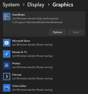

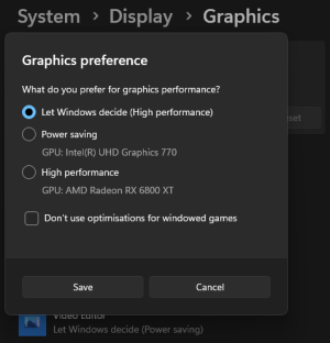

When you say "your videos" do you mean locally stored (personal) videos? Does the problem also apply to streaming 4K videos from YouTube or some other streaming service?
If YT videos are fine, then you should probably focus your attention on the installed codecs you have (or their config). If all high definition videos play back poorly, then you might want to perform a clean re-install of your Nvidia driver. You can also check what happens when you re-enable the iGPU as well (there's a BIOS option that allows it to function alongside the main dGPU, as a secondary option). Having the iGPU enabled is the preferable way anyway, and if enabling it fixes anything then you might want to check video codec configuration or even Windows configuration for GPU utilization.
This Windows config part is probably unrelated to your problem, but it's good to know it exists. (especially for anyone using a laptop as well)
