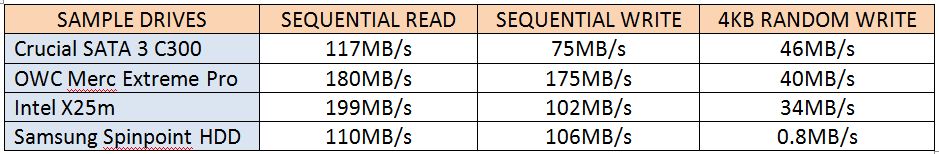

Reviewed the Vantec USB 3 dock and, in comparison, you should be getting higher numbers. Here is what I received:
These drives were all plugged into the dock and it was connect via USB3. You will note the HDD gets the scores as specified by the manufacturer. Here is that ATTO:
