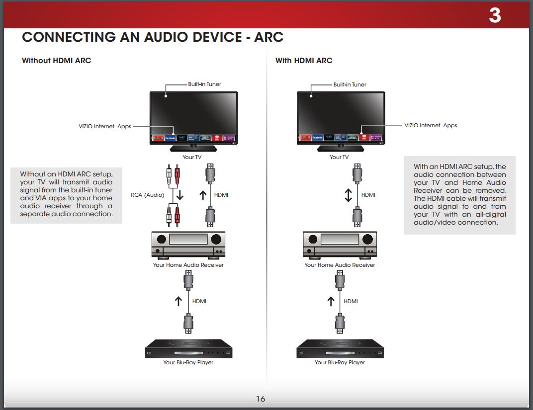

The thing is, the TV has the Smart apps for streaming built in. There's no HDMI out on the TV, only inputs. The only audio outputs on it are the optical and the red / white RCA.
It does have HDMI inputs, but, well maybe I don't get how HDMI works.. Wouldn't the signal have to come from 'something' TO the TV to use an input? How would the sound come back out of an input HDMI when i'm using the built in streaming applications?
Here is the TV I have.
http://www.amazon.com/Vizio-D-Series-D650IB2-65-Inch-Full-Array/dp/B00NS65PW6
http://cdn.vizio.com/documents/downloads/hdtv/D650iB2/UM_D650iB2.pdf
THE TV INPUTS
FYI My tv has an HDMI ARC

Ok i'm starting to answer my own question. Looks like I just need to buy a receiver. I'm making it harder than it really is. I just learned about ARC in the last 10 minutes.

the opticle cable should carry 5.1
it is even shown in the second image you linked
Yes optical will do 5.1 dolby digital and in some TVs DTS 5.1. An HDMI cable from the TV to a receiver using ARC will provide the same, except you only need one cable.
