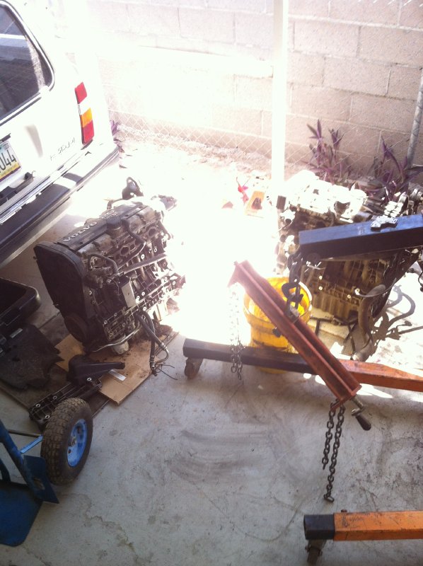

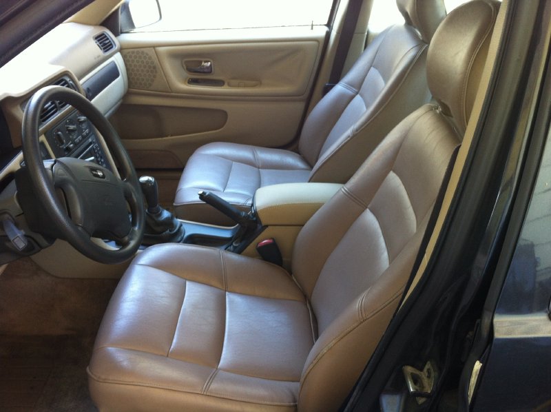

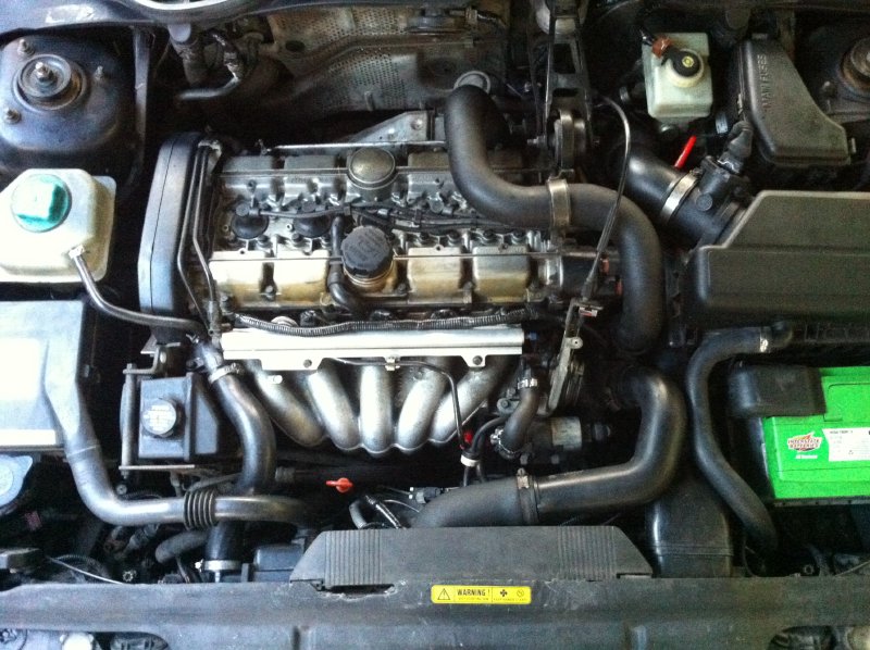

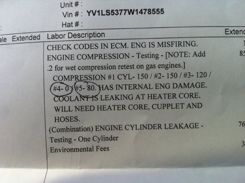

I came across a 98 Volvo S70 for sale, 254k miles, turbo with manual transmission. Stock, they make 236hp, 5 speed manual options was rare. I went to check it out and it has non-torn front seats!!! The car was sold with an engine with dead cylinders and I have a working engine at home, so that is not big deal to me. I was told the car have its clutch changed a few years ago, there were also around $1800 worth of receipts of radiator change, struts change, brakes, and etc done few months ago. After a short negotiation, car was mine. Plan was to fix it up and sell it for profit.

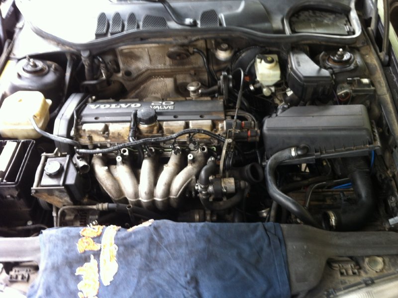

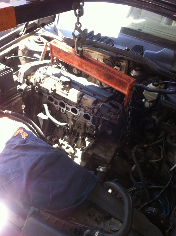

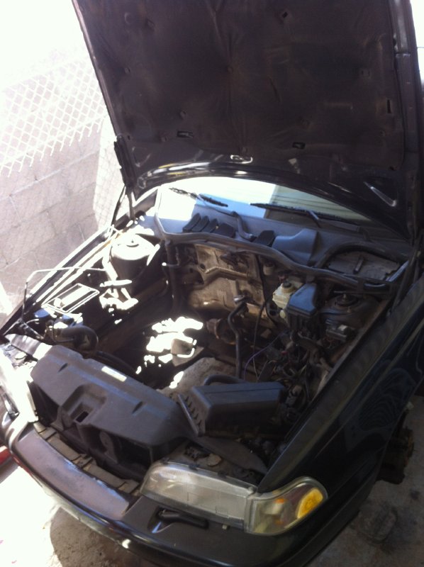

After I took everything apart, here is what I found:
Has two dead cylinders on the engine.

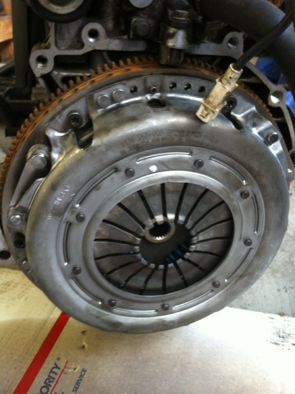

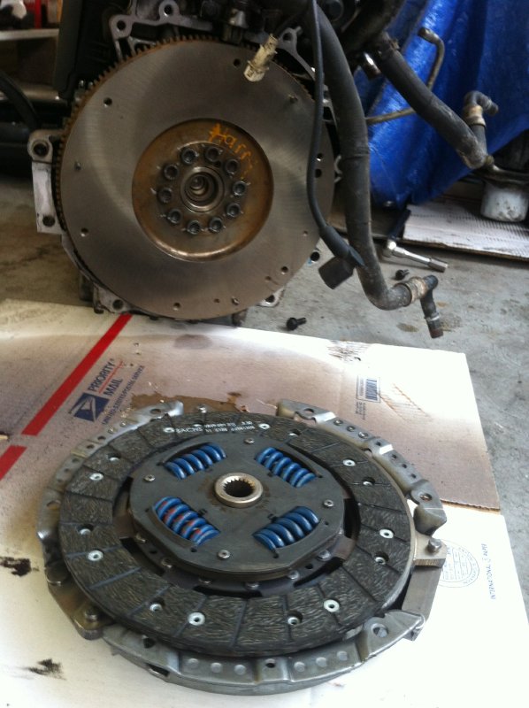

Clutch disc worn to the rivets (factory 254k clutch, most likely)
Leaking heater core

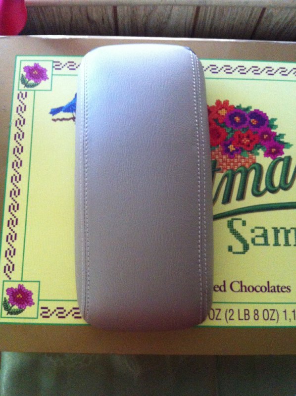

Arm rest skin is all cracked

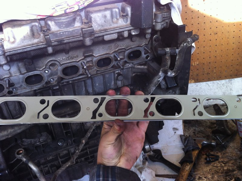

Exhaust gasket are all in pieces

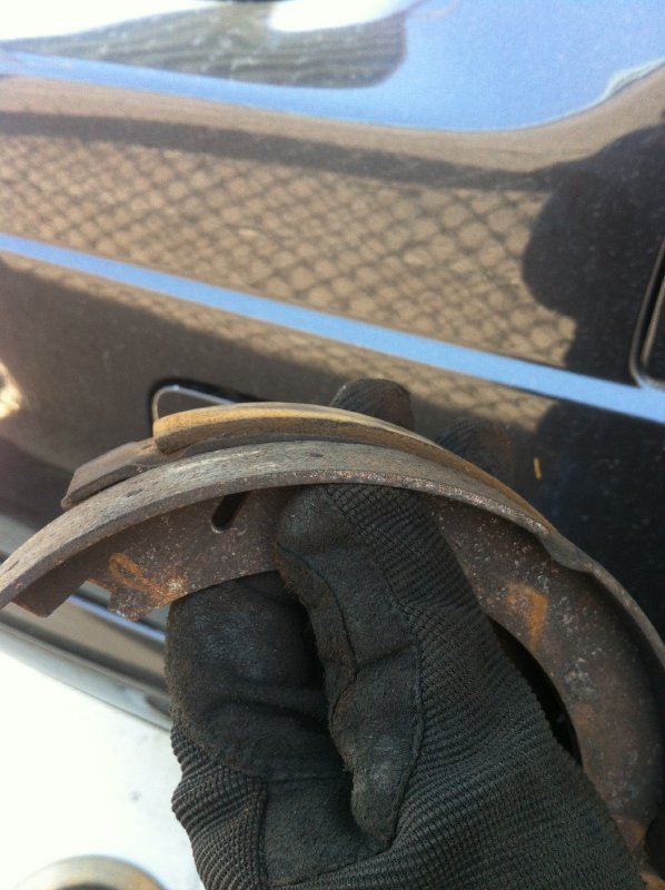

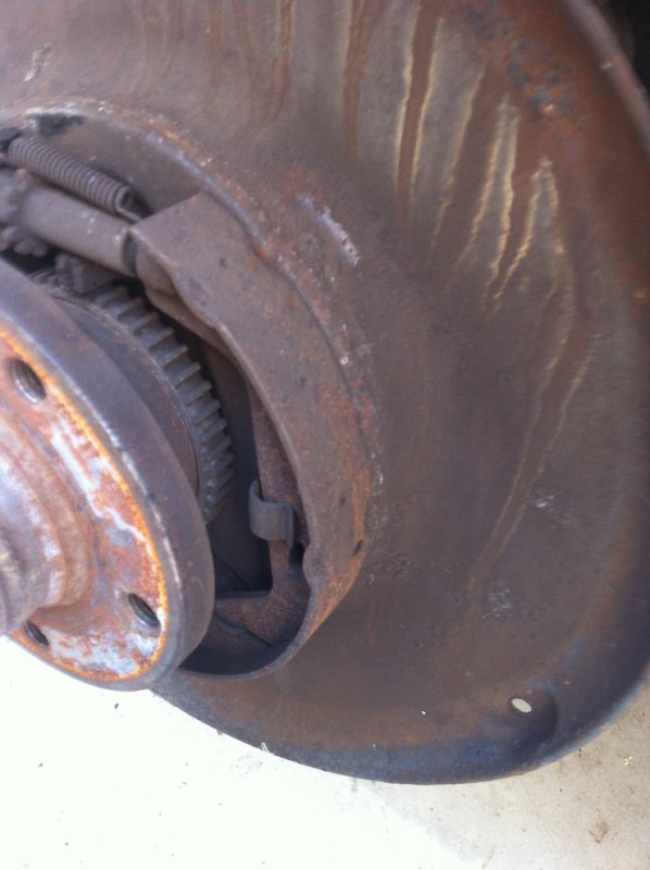

Hand brakes adjustment is way off, due to one side brake shoes have no meat

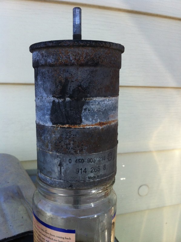

Dead fuel pump

See the shiny rivets? The disc is worn down to the rivets!
