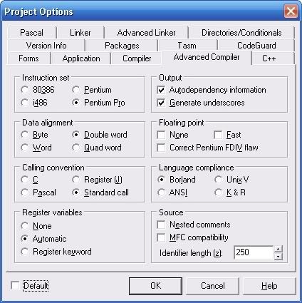

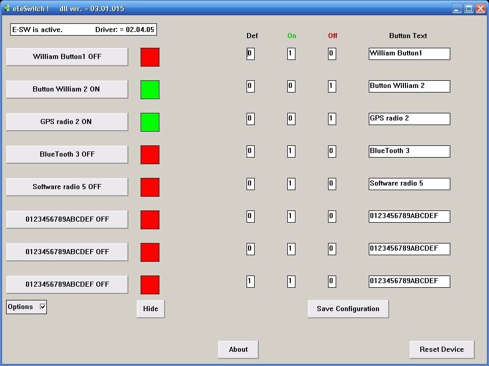

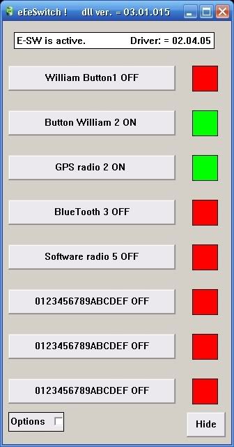

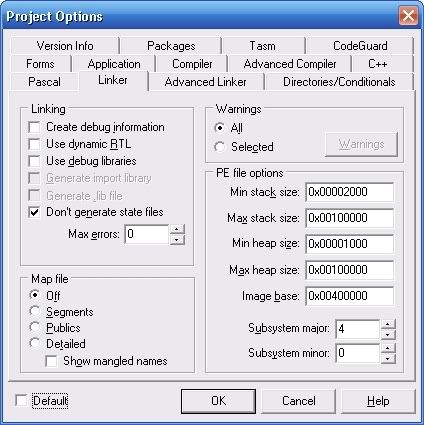

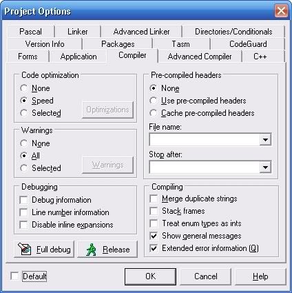

I hope someone can help me with this.
For some reason i do not understand, i cannot use the "CVI_FT_GetLibraryVersion" (or any other dll function for that matter)
outside the main function or the call back function. When i use the function inside winmain or the callback i do not get an exception. When i used in a function outside, i get an exception with the text :
project test raised exception class EAccesviolation with message 'Access violation at address 00090396' Read of address 00090396.
The weird part is that i get the exception only when selecting release mode in the compiler settings.
When i use the full debug mode i do not get any exception.
I am working with borland c++ builder 5.
I am still learning, if anybody has an idea i really appreciate it.
Here is a part of the code.
