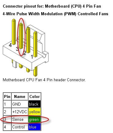

Here's the pinout for 4 pin PWM CPU fan connectors:
The component is located between pin 1 (Ground) and pin 2 (+12 Volts) so most likely (not certainly), it's a decoupling capacitor. As I said, above, the board should continue to work without this cap until you encounter the specific interference it is intended to stop.
