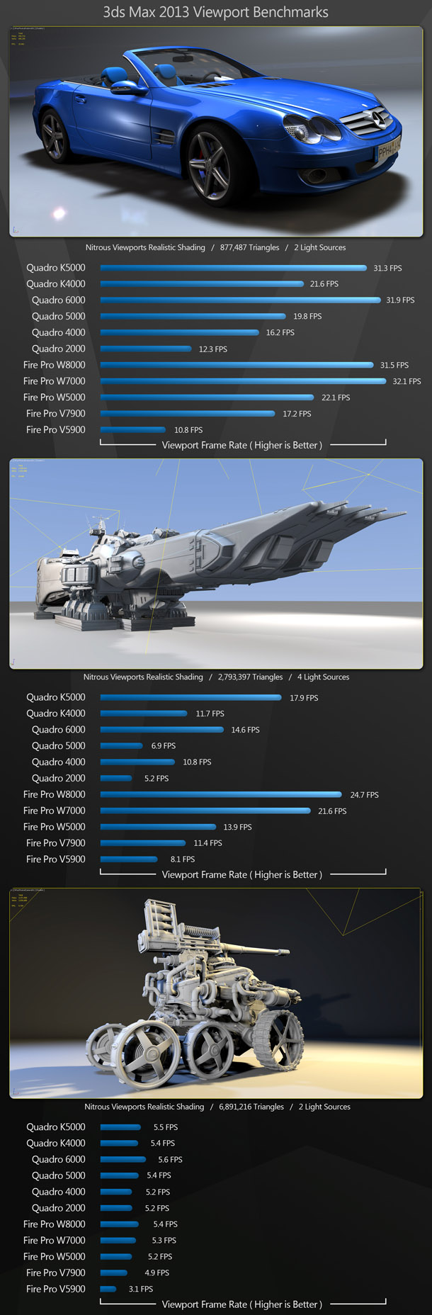

3D Studio Max:
Pretty even if you go Nvidia or AMD.
