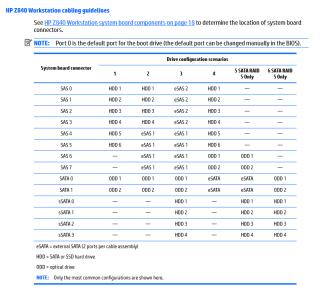

Bro there are configuration guidelines/rules outlined in the Maintenance and Service Guide showing which ports are SAS/eSAS, eSATA, SATA (primary), and "sSATA" means Secondary SATA. Common supported drive configuration scenarios, Page 64
Screenshot 2024-08-25 at 14-28-18 HP Z440 Z640 and Z840 Workstation Series Maintenance and Ser...png
Also the sSATA requires at least TWO drives connected in order to enable the Option ROM to display, to configure a RAID array on the sSATA ports. This is all consistent with Intel's guidance and own implementations for server/workstation boards of this era. e.g. https://www.intel.com/content/www/us/en/support/articles/000056356/server-products.html
