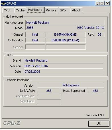

However, there may be a problem, as it seems that this version is equipped with an intel 910GM chipset, not the 915GM, but I am not too sure about that. What do you all think? At the HP website, you are able to select both centrino and celeron processors for the NX6110. Do you think that they will make two different motherboards for each chipset, for each notebook? Also, what will change (to the comments just stated above), if it's an intel 910GM chip? Will it still support 533mhz FSB?
Ok, this is something I did not know. I must have missed the 910 chipset as being a lower-cost entry chipset meant only for CeleronM's. No 533mhz FSB support, and it can do DDR or DDR2. Interesting. Download CPUz or that Intel utility and it will let you know the exact model number of your chipset.
Here is a cpu-z capture for my nx6110 Celeron-m
NX6110 celeron-m
I too wonder whether upgrading to pentium-m would work because according to Intel the 910gml chipset is only supposed to support celeron-m cpus. However cpu-z says it's a 915 chipset. 😕
The laptop might also be bios locked too to prevent from swaping pentium-m cpus ???
I just checked with cpu-z and it detected it exactly as in the pic xenon posted. Intel utility detected it as 910/915, as did dxdiag. I dont know which is which, but I am thinking that the 915 is more logical since this model is supplied with a centrino processor too.

Got my nx6110 on Tuesday. Really nice laptop for the price and the best keyboard I've used on a laptop except for a couple of Thinkpads.
I took a screenshot of CPU-Z and it looks like the board is the same as xenon2k's. Mine shipped with a P-M 730 (1.6GHz/533FSB) instead of a Cel-M, but same motherboard model with a different rev. # and a newer BIOS.

The statement above confirm that Serp86's HP NX6110 can support 400/533 dothans if and only if it has the "910/915" chipsets. The worse thing that can happen is if an update is needed to support the 915spec. The 400mhz dothans will work and it make sense vs. 533 for an upgrade since rest the computer can' benefit from 533.
The motherboard in my Asus is: "82915PM/GM/GMS, 82910GML Host Bridge" and I got a 1.7a(400mhz) in there.
"A common mobility board can be designed with the Mobile Intel® 915GM Express chipset and Mobile Intel® 910GML Express chipset to facilitate a scalable mobile platform."
