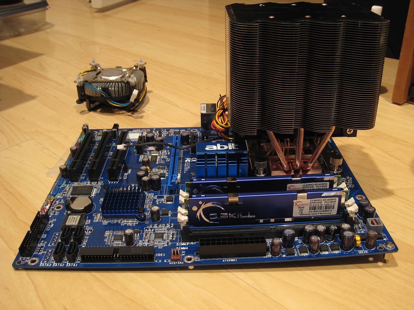

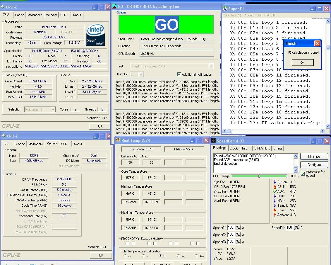

Hows this OC look?
IP35-E i cant get my ram past 1000mhz so its making things tricky to maximize my OC.
This is the ram im using

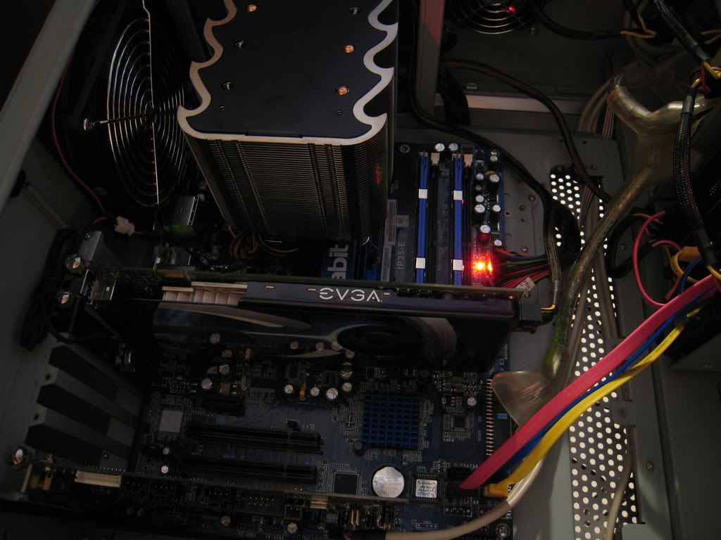

Orthos has been running Small FFTs since i posted... 3.5hrs no errors yet 🙂

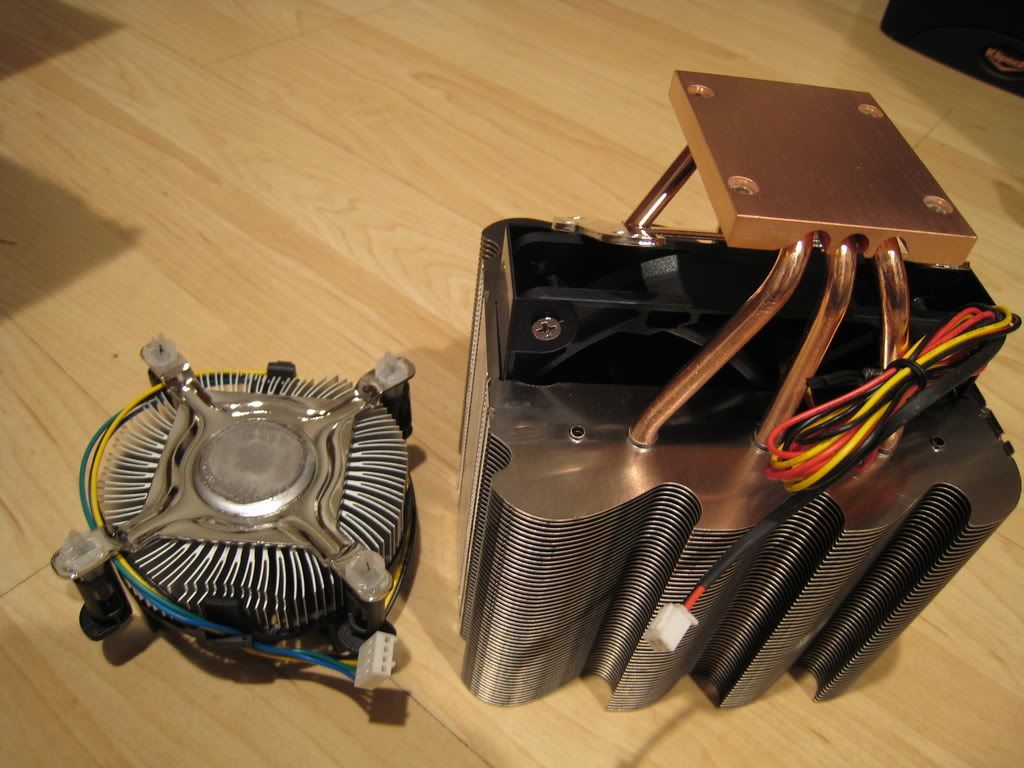

Once i get the aftermarket cooler i'll see if i can OC to 4Ghz at less than 1.3V vcore. I can do it at 1.3 now, but the temps will go to 63c while running orthos. Stock cooler is pretty weak i guess.

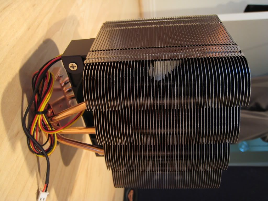

I use a lapped Tuniq and have a lapped 9700 that I bought before I knew any better. Now the Zalman does a good enough job on one of my quads with moderate voltage. With 45NM chip things would be even better with the 9700 but I just cannot justify the price tag even today after the price has dropped a bit. The Tuniq can be had for less than 40 bucks now shipped so that is much better deal IMO.
I get 52-54 load temps on my E8400 at 1.42 volts with a lapped Tuniq.
Looks good overall. SpeedFan seems to have a compatibility problem seeing both cores on your Xeon. Core voltage is well within tolerance too AFAIA. I think it looks good!
Get CPUID's Hardware Monitor as a second temp monitoring option. Temp measurements on PCs are notoriously inaccurate, and SpeedFan is way too forgiving.
But overall, I think you're in good shape. When you get a better cooler you might be able to shoot for the Big 4.
CPUID takes the TjMax of 105, yes? I've been using Real Temp b/c it is shows TjMax 95 which is supposed to be more accurate for the 45nm C2Ds. The difference will be 10c between real temp and cpuid/core temp. Am i wrong in believing the lower temp is more accurate?

Just from a personal standpoint, I always accept the highest reading I get from a range of measurements. But SpeedFan is basically junk at this point. Your CoreTemp is much mroe accurate. Now, I want to get further edumacated on the specific temp readings and their meanings, but by the time I get to these postings I'm already worn out from work and all I want to do is play... figuring stuff like that out sounds too much like work to me at the moment.
I think you make a good point. I believe the most pessimistic readings because it gives me more of chance to OC and still safeguard my system. 🙂
With that Tuniq, you should be able to take a shot at 4.0 GHz!

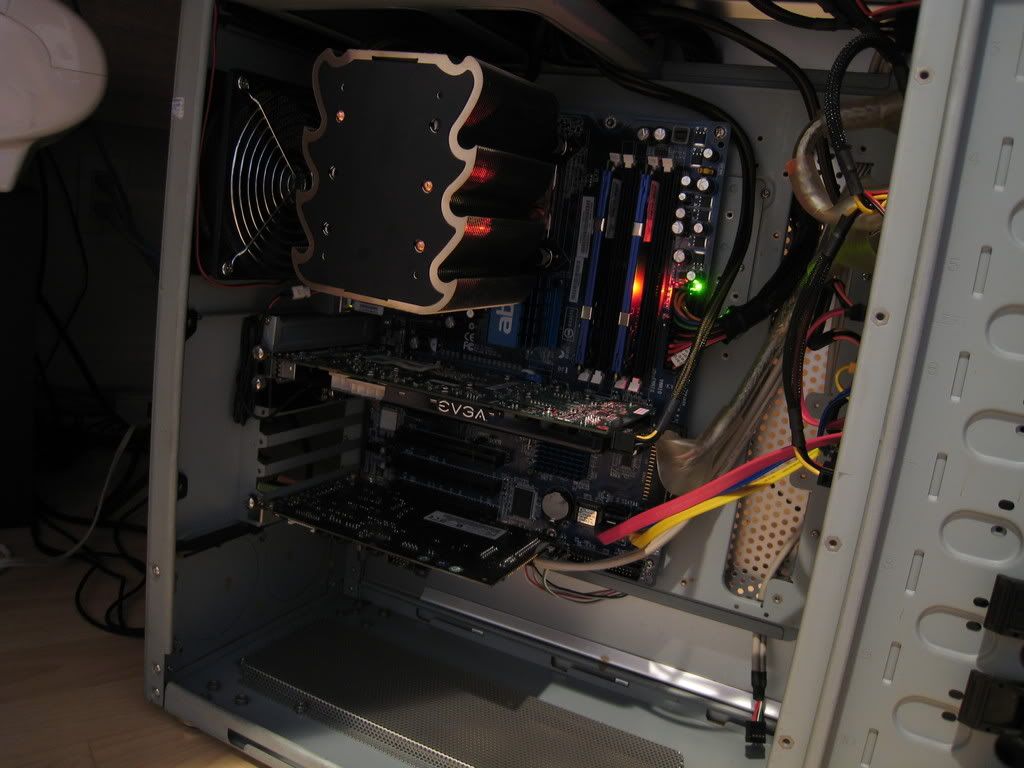

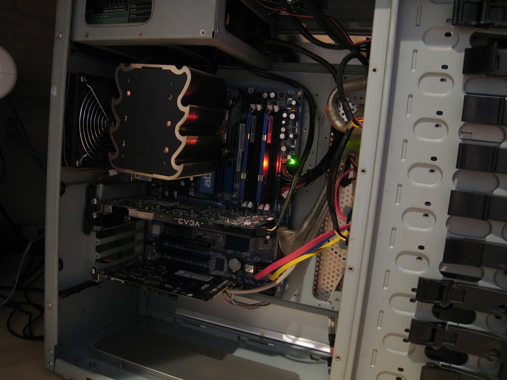

Well I OCed to 4Ghz and max temp showed 63c in Core temp which is cooler than it was at 3.7Ghz with the stock cooler.
