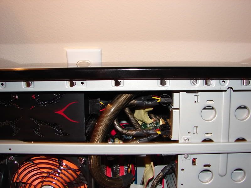

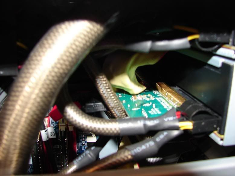

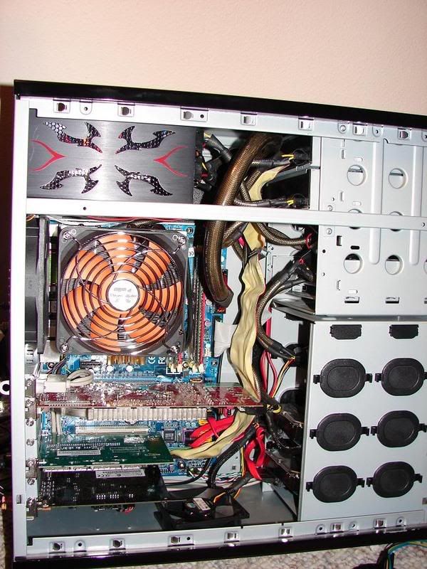

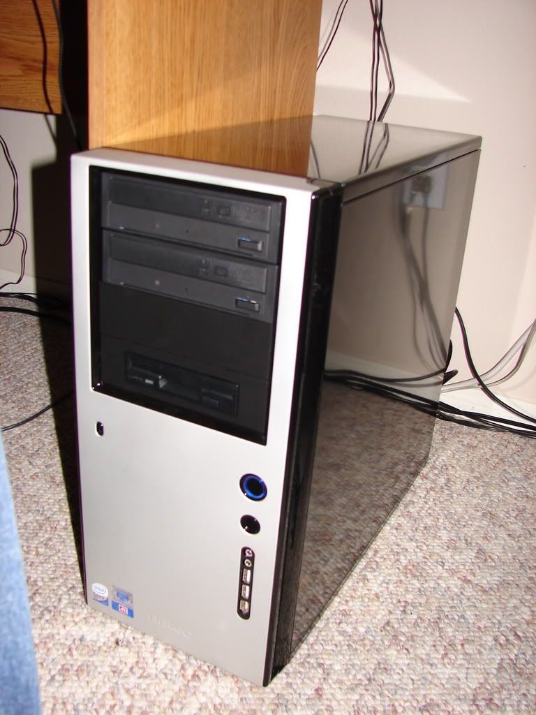

that's a solo- my system temps rarely exceed 40 and I've got everything that can be overclocked, overclocked. check sig for that but here;'s my solo set up
entire system
http://img.photobucket.com/albums/v319/xdiaboLix/604small.jpg
upper section
http://img.photobucket.com/albums/v319/xdiaboLix/DSC00607.jpg

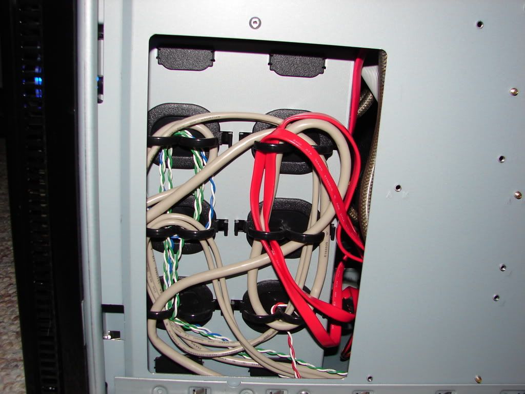

cable management
http://img.photobucket.com/albums/v319/xdiaboLix/DSC00617.jpg

and as far as the fans I can't hear the 92 02 mm fans at all the 120 in the back is next to silent two (i keep mine on med settings) my cpu makes the most noise lol.
I highyly highly highly recommend the 2 92's they worked wonders for me cooling wise I was able to remove 6 arctic cooling fans I had in there before and replace them with those 2 and I have lower temps now. lol

Oh that cpu cooler itself is silent, it's the sound of the information being processed that's loud :p. My gf has a stock no OC no nothing AMD Athlon 3000+ set up that she says runs louder than mine even at its loudest moments, so I'm not sure.
As far as fan's I just have that 1 80 mm within the case and 1 exhaust and 2 intake, the exhaust is arguably the loudest, with a OC of 2.8ghz the temps really dont jump much at all so you could probably run the fans all at low while maintaining an even air pressure inside.
I bought my fans(92mm) at a local fry's they are the antec tri cool I believe, I threw away the packaging so I'd have to open the case up to be sure. They work wonders for the HDD's (my seagates are supposed to run hot) and I personally think by regulating your air intake to the lower section of your case your allowing the coolest air in your room to flow in. Thus keeping it nice and cool inside rather than intaking from the exhaust of your PSU. then again thats all my opinion. :p
as far as overclocking, as long as your airflow is good you can get a good OC out of both GPU and memory no sweat.
