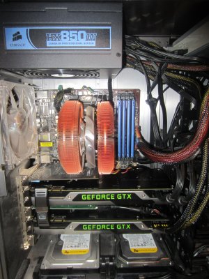

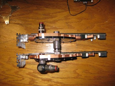

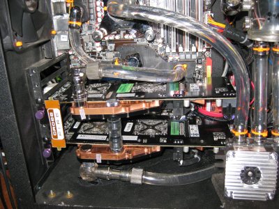

I'd personally enjoy a picture of the Xfire setup if you want to post it here.

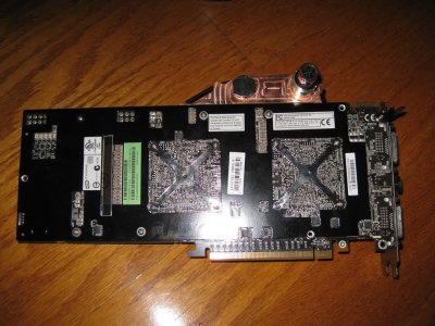

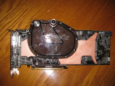

Heh don't want to hijack.. but here is a dual die gpu.
Xfire on a single card!

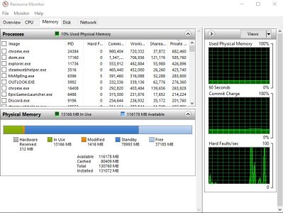

Do you happen to have a Ramdrive setup?
Or samsung Magician set on cache?
Can you copy and paste your resource manager in windows ?
Start -> Resource Monitor.
Then under Memory Tab see what it says.
It should look something like this:

This is a clean install of Windows 7. I have installed a couple of utilities and all the drivers except the video drivers. I re seated the ram but the board went from the antistatic bag to the case so there is no dust involved. All the hardware monitors show that there is 32gb installed. Resource monitor reports 16562MB hardware reserved. It also reports 11583MB cached. I haven't done anything with a ram drive or cache settings.

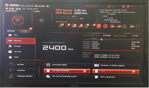

OK, I never thought PCs could be this weird. People solved this hardware reserved RAM issue by reseating RAM sticks, blowing out the dust from RAM slots, identifying a bad stick, putting one stick first then the other and finally, the craziest, cleaning the pins of the CPU!
I see this problem all over the place. MSI x470 gaming max plus. I already re seated the ram sticks. They are in the right slots. A2 and B2 which is kind of counter intuitive. One would think it should be A1 and B1. This is what my BIOS screen looks like. This has A1 and B1 populated. The only thing weird is that the total memory size my board is reporting in the upper right is 16384MB but like this example 16384 is reported in slot A2 and B2. Would switching the ram sticks to A1 and B1 cause any harm to the board?

Oh ok. I thought the screenshot was of your own BIOS screen.
No just an example that matched mine except it is using 8GB sticks instead of 16GB. The computer isn't connected to the internet yet. I started the musical ram thing. Both sticks are good. When I put one in slot A2 Windows reports 16GB ram with 16GB usable. It shows 78MB reserved for hardware. This is looking like Windows stupidity. I'm going to try slot A1 next.
