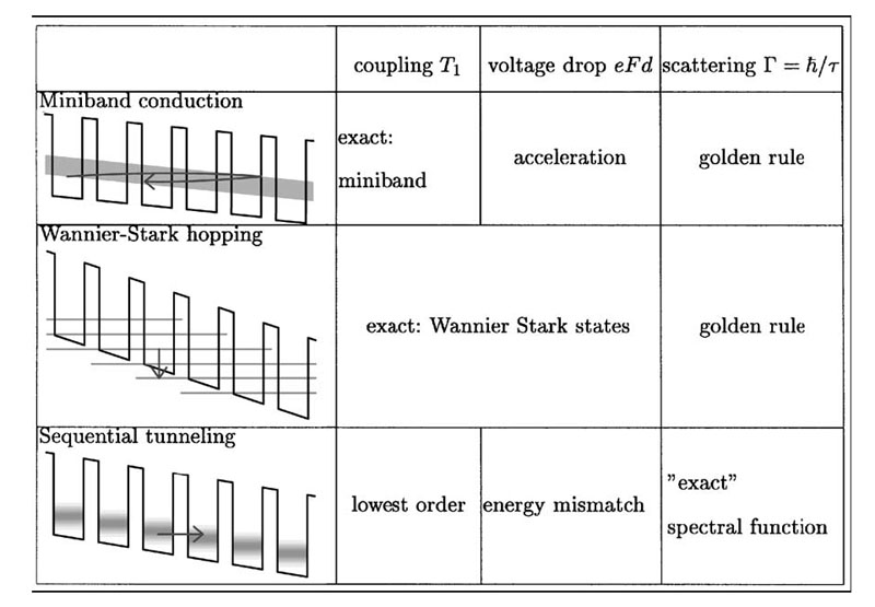

PS, thanks for the post you made on Bravais super lattices, I was stuck in the ER for 6+ hours with only my iPad. It made for interesting reading and brought me right back to my undergrad QM studies. Suddenly, I have an urge to get my go for an M.Sc. in Physics. :eek:

PS, thanks for the post you made on Bravais super lattices, I was stuck in the ER for 6+ hours with only my iPad. It made for interesting reading and brought me right back to my undergrad QM studies. Suddenly, I have an urge to gat my go for an M.Sc. in Physics. :eek:
