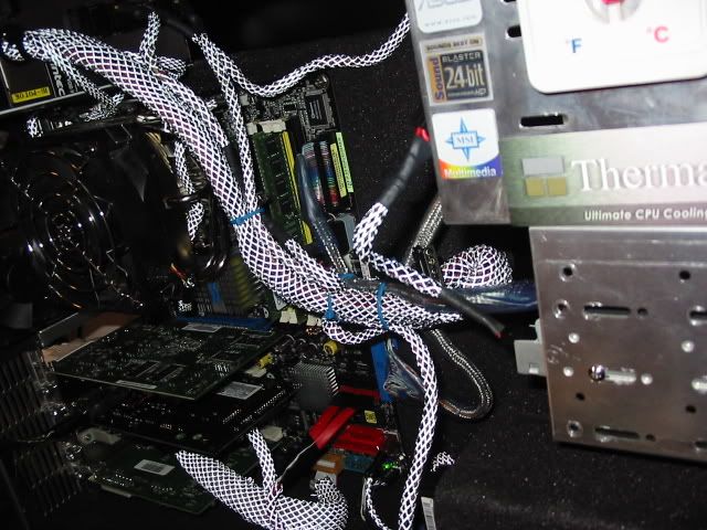

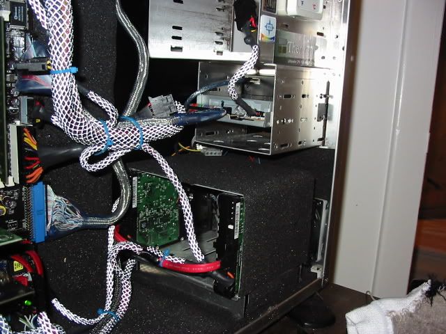

Are you talking about the Acoustipack stuff? SPCR did a review of it and they said it works wonders. But those guys are freaks when it comes to quiet. If it's over 25dBa it's loud in their book.
In my opinion, it's overrated. I have a P160 with 2x120mm fans and I hear almost nothing. I doubt that damping stuff would make a huge difference to me.
from what I have heard it mostly cuts down high-pitched noise. but other than that it doesn't do all that much.
