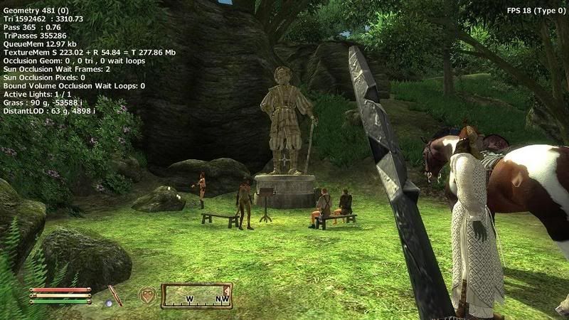

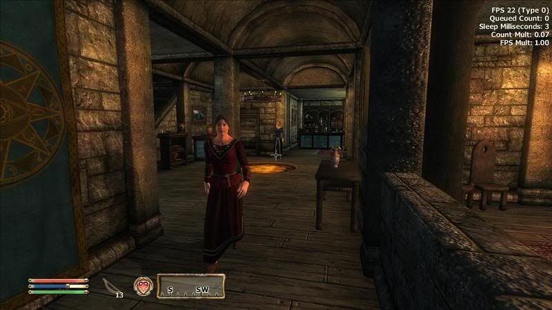

ok I reinstalled the 6.6 warcat drivers and theres no more crashing and everything is very stable now. Still the graphical anamolies with the oblivion gate when I enable AA but its not a big deal. Company of heroes works fine now. Fps dips in certain areas like this http://i133.photobucket.com/albums/q59/keninishna/ScreenShot11.jpg
http://i133.photobucket.com/albums/q59/keninishna/ScreenShot6.jpg
maybe some tweaking can fix it but oblivion is the only game that can ruin my framerates.

Those FPS dips look just like mine in similar areas. However, you're 3DMark scores are better. I still need to get around to testing. I've been too busy trying to find a new place to live though!

Don't use Adaptive AA @ all. DO NOT use Super-Sampled AA since it will disable Crossfire for this game. Again, the gates deal is a side effect. However, with this mod you can get rid of it literrally to make it go away as well as a nice performance boost when around oblivion gates : http://www.tessource.net/files/file.php?id=3726
Use 4xAA+HDR. + 16xHQAF

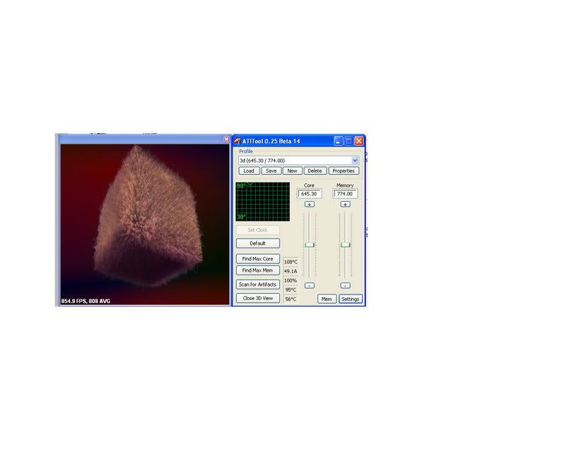

Heres a pic of ati master card under load:
http://i133.photobucket.com/albums/q59/keninishna/ati-tool-master.jpg
slave card under load:
http://i133.photobucket.com/albums/q59/keninishna/ati-tool-slave.jpg
I'm not sure why it overheats so much but its taking in around 49 amps so I guess thats it. Voltage is set to 1.425 on both cards.
