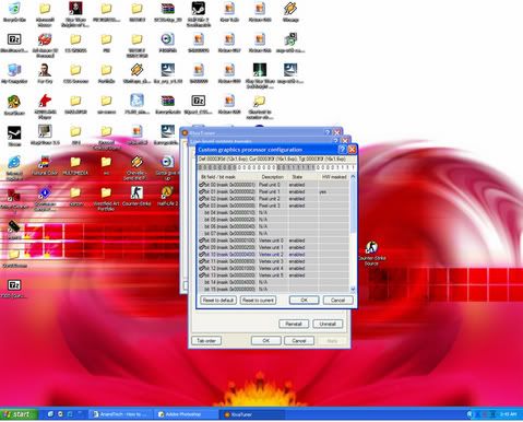

Yay! My BFG 6800 OC unlocks with no problems.
Weird thing is, when I went to unlock the Vertex shader, IT WAS ALL READY UNLOCKED. There was only 1 "yes" to check off. I bought it used, is there a possibility that the previous owner flashed the BIOS?
EDIT- here's a picture of my 'custom menu'
