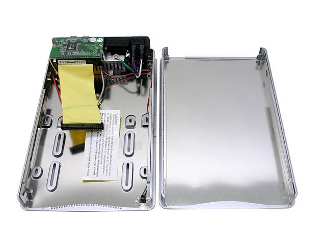

can anyone post instructions on how to take a apart an external enclosure?
i bought an external dvd burner a few years ago...but its basically the drive in an enclosure..looks a lot like this one
http://www.newegg.com/app/ViewProductDesc.asp?description=17-146-182&depa=0
i want to switch the dvd drive for a hard drive instead
it came assembled already so i have no idea how to take it apart..i got the sides and the top off but i dont see how to get the drive out? thanks
The plastic strips on each side can be removed by GENTLY prying each one loose in the back. Use a medium size flat head screwdriver. Once loose in the back the side panels can be slid forward (~1/8 inch) and off. The top will then be free to open.
Now this is assuming that yours is the same as the one you've shown in the link.
