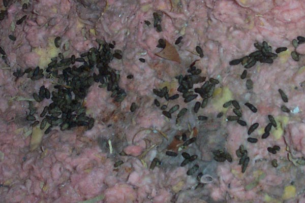

I would never trade the 10 other benefits I listed for cost, saying that ONE benefit is on par with the cheaper material and then tossing out all the other things I listed is one of the worst internet argument tactics there is.
I have pulled out and replaced way too much sunk fiberglass that had mouse droppings and stolen material for nests then I will ever find acceptable. You get what you pay for.
and actually I got Roxul for cheaper than any of their on shelf fiberglass product they had.
