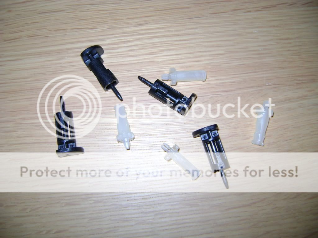

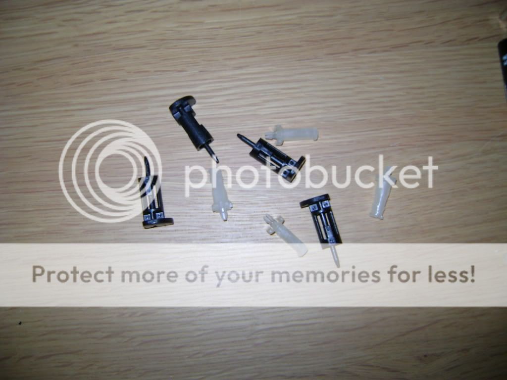

Originally posted by: Navid
Originally posted by: daw123
The bracket on my BigTyp is so naff, that the plastic push pins were easily removed. I just twisted the outer part of the pin anti-clockwise to the inner part and it separated. I didn't even need to break them / use brute force (although I was willing to do so to remove them).
That is interesting.
Was this the case for all 4 of them or just one?
Do you still have the pieces? Can you show any pictures?
Why would the tabs not hold the pieces together?
I have done this to 3 different coolers (Intel stock, Freezer 7 pro and CM Hyper TX2) and the push pins have been consistent.
Why would a manufacturer not use the standard push pins?
Very interesting.
Sorry Navid for being so late in posting photos. I had to borrow a camera from work.
Here are the photos:
http://i429.photobucket.com/al...sh%20pins/DSC00387.jpg
http://i429.photobucket.com/al...sh%20pins/DSC00388.jpg
