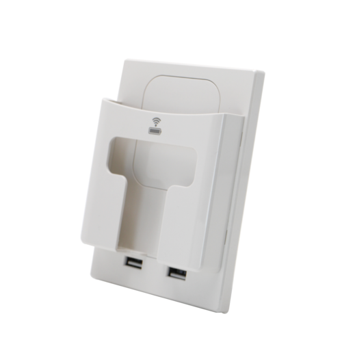

i have an old phone that i would like to mount near a normal light house switch.
i know i will probably need something like this gang box https://www.amazon.com/CARLON-THOMAS-BETTS-B225R-UPC-GANG/dp/B001DPXC2Y/
and i will 3d print some wall plate to make it look nice and clean like https://www.amazon.com/Legrand-Seymour-TP262W-Master-Decorator/dp/B0001M6FRO/
now, what do i need to charge the phone? how to tap into the existing power line while still have the light switch function as normal?
pcgeek11
Jun 12, 2005
22,225
4,932
Get one of these and install it into a double gang box with the switch. Then wire it to the hot and neutral wires of the switch in parallel.
It can do wireless charging or charge via one of the USB Ports.
This would definitely be the solution, but I would find a domestic company to buy it from so it's not junk and a fire hazard without recourse.
The other option would be to get a triple gang and put an outlet next to the switch that has usb ports and then hardwire the usb behind the plate.
this is very interesting. i didnt know such a thing exists! for me a little too bulky. i need something more flushed into the wall.
i think this can work https://www.amazon.com/gp/product/B07SGQ6XXR/ . looking at the photos, i only see a label with "AC input." does it matter where my hot/neutral go to?
I definitely wouldn't stick that in the wall unshielded like that. :eek: Remember, if you create a fire hazard doing this and burn your house down your insurance will probably deny your claim if they find out this was the cause.

Then just fashion a bracket for your old note with charge cable. You'll want to allow airflow behind the phone since constant ac power will make the phone warmer.
Or add a regular socket next to light switch. Mount phone to wall and just plug in a charger and charge the mounted phone at night. Lion battery doesn't really like to be charged at all times.

This is kind of what I was thinking of except going with a 3x gang putting this as an outlet next to the switch and then connecting directly to the solder pads on the usb sockets behind the wall plate and running it to the phone. Then it would all look seamless. You could even use a silicone plug on the usb you're using to make sure it doesn't get used for anything else.
if the thing burns your house down you still have noo recourse! The company won`t pay for a new house......
70,164
13,571
Depends how the switch is wired. You're going to need a hot and neutral. If power feeds the switch, then the fixture, you're in luck. But if the power feeds the fixture, then goes to the switch, you won't have a neutral. You can cheat and use the ground but that's not a good idea.
A clean way to do it might be to replace the box with a double gang then install an outlet that has built in USB next to the switch then mount the phone then make a short USB cable. The outlet would be powered all the time and switch would work as normal for whatever it's switching.
I would not buy electrical stuff off Amazon though some of that stuff is built to a frightening standard. You are buying direct from China and not from a reputable retailer that will have a bit more scruntiny over what it sells because they don't want to burn people's houses down and be held liable.
