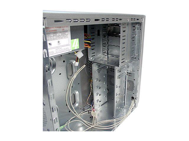

Looks like you need to take off the front panel and then thread screws through the holes (unless there's something to mount them to between the metal case and the front panel, but it looks too narrow for that.
You should be able to get the front panel off by squeezing the little plastic parts of the panel that are attached to the side of the metal part. ( did that make any sense? :confused: )

ya it makes sense but i guarentee ill break something...there seem to be little clips on the inside front of the case...i dont know if thats what you mean though...

Yeah, I meant the little plastic clip things. I've never worked with that case before, but from that pic it looks like that's what you should do.
I've broken a couple locking clips on front panels in my day. If you break one, look on the bright side... you don't need all of them to keep the front panel on :)

after further review...even if i punch out those holes, the front of the case doesnt have any instake holes...it makes no sense for it to even have those two fan mounts. The one I has differs from the one on newegg as it's back panel only has room for 1 120mm/80mm fan.
See what I mean...

Is there any holes on the bottom of the front panel?
I think it would be a good idea anyway even if there aren't any noticable intake spots on the front panel.
If nothing else, it will give you at least a little airflow around your hard drives, which is a very good idea as heat buildup is a harddrive's worst enemy.
For future builds: antec makes some very appealing case/psu combos with great airflow, solid construction, and reliable powersupplies. :)
( no, I don't work for antec ;) )

i used to have a case something like that one
and there is a hole right between the front panel and the case..

My wife's case is exactly the same internally as the one pictured on NewEgg. (different faceplate though)
Her system runs quiet and cool, but it was a lot of modding getting there.
In back I cut out the fan grills and installed wire ones. The front though, I not only had to cut out the fan grills, but I cut out the base of the faceplate for intake. I also put some cheap led feet on it since they raised her case 1" off her desk giving a little better airflow.
Really though...as was said before if you can do the mods you'll be fine, otherwise I would shop for a new case.
