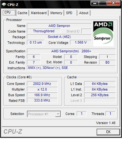

i don't mean to be a bother, but i have recently stumbled upon SP2004 as i was hoping to find out if either my 2 new 1gb ram sticks are bad, or if it's my cpu since i have been getting random restarts.... i just don't understand the results. perhaps someone could point me in the right direction to decipher this?
thanks in advance.
Type: Blend - stress CPU and RAM Min: 8 Max: 4096 InPlace: No Mem: 1759 Time: 15
CPU: 2002MHz FSB: 167MHz [166MHz x 12.0 est.]
9/15/2008 7:54 PM Beginning a continuous self-test to check your computer.
Press Stop to end this test.
Test 1, 4000 Lucas-Lehmer iterations of M19922945 using 1024K FFT length.
Test 2, 4000 Lucas-Lehmer iterations of M19922943 using 1024K FFT length.
Test 3, 4000 Lucas-Lehmer iterations of M19374367 using 1024K FFT length.
Self-test 1024K passed!
Test 1, 800000 Lucas-Lehmer iterations of M172031 using 8K FFT length.
Test 2, 800000 Lucas-Lehmer iterations of M163839 using 8K FFT length.
Test 3, 800000 Lucas-Lehmer iterations of M159745 using 8K FFT length.
Self-test 8K passed!
Test 1, 560000 Lucas-Lehmer iterations of M212991 using 10K FFT length.
Test 2, 560000 Lucas-Lehmer iterations of M210415 using 10K FFT length.
Test 3, 560000 Lucas-Lehmer iterations of M208897 using 10K FFT length.
Self-test 10K passed!
Test 1, 4500 Lucas-Lehmer iterations of M17432577 using 896K FFT length.
Test 2, 4500 Lucas-Lehmer iterations of M17432575 using 896K FFT length.
Test 3, 4500 Lucas-Lehmer iterations of M17115073 using 896K FFT length.
FATAL ERROR: Rounding was 0.4999990463, expected less than 0.4
Hardware failure detected, consult stress.txt file.
Torture Test ran 1 hours, 17 minutes 50 seconds - 1 errors, 0 warnings.
Execution halted.

i am not OCing my cpu, but i was trying to work out why i was getting the random restarting. since that post i reckon i have worked it out. when i ran memtest on each stick individually for about 200 passes, there were no errors. but when put in my pc together, i had problems. after reading up on ram timings, i decided to adventure into the bios and muck around a bit and found that when there was only 1 1gb stick, the settings in bios seemed to be set properly. but when both sticks were installed the pc applied different timing settings. something like 3-4-3. so i changed it to 3-3-3 and since then i have had no crashes :D
truth be told, i just got a new video card and would like to start goofing around with some of this OCing to see what my old box can do ;)
AMD sempron 2800+ (Thoroughbred)..i don't know what a VID is lol
here is a screenshot of CPU-Z http://i178.photobucket.com/al...w243/godfodder/cpu.png
and my ram is 2x 1gb Hynix DDR3200 200mhz
Drsignguy
Mar 24, 2002
2,264
You can download coretemp and it should tell you you vid of your chip. Don't really know for sure if it will work ( it should ) but give it a shot and then you will know, hopefully. And what a differance a generation or 2 makes compaired to voltages. Wow!
