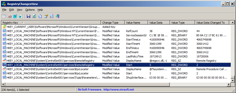

I have app(s?) somewhere that monitor all changes made during an "event", from when you set it to start monitoring changes, until you select the end point to stop, but I can't recall what they are called, as I haven't used them in many years and may not even be compatible with current win10/11. Otherwise, you can use powertools like Process Monitor to watch registry changes or compare two versions of the registry with something like Nirsoft's RegistryChangesView.
You could also look over the other sysinternals and nirsoft system utilities (among other sources) to see if anything else they offer has any use to you. For basic tasks like these, there should be freeware available to suit most needs. At least make a backup of registry entries and files before removing any.
