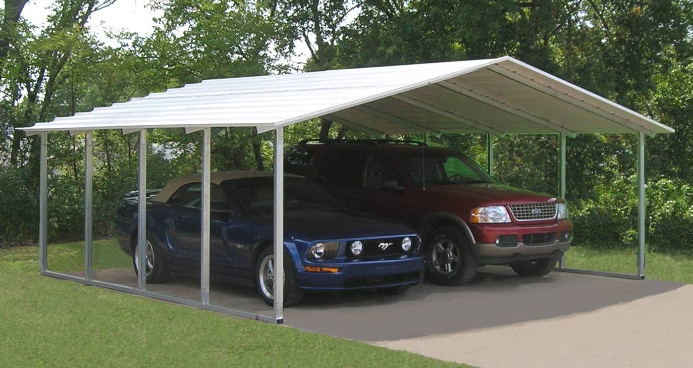

put up something like this... and will probably cost ya under $100
