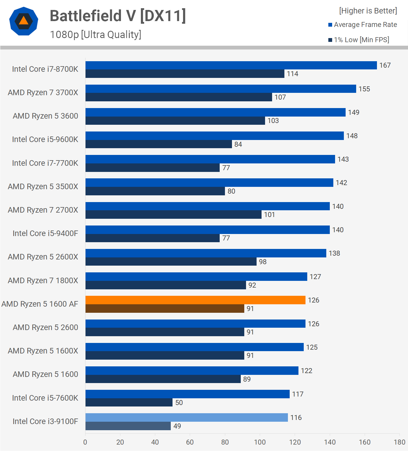

I just went ahead and tossed TechSpot's data -- not from this review, but from their 10900K and 3100/3300X review (which includes same system setup for all systems) into Excel and used the Data Analysis add in for some basic evaluation.
Setup
Independent variables were cores, threads, base freq, boost freq.
Dependent variables were average FPS, 1% lows, and what I call "delta%".
Delta% is the gap between average FPS and 1% lows, represented as a percentage - 1% lows divided by average FPS. The higher this percentage, the closer the 1% lows are to the average FPS, and the "smoother" the game would likely be.
Results were from Battlefield V on Techspot's reviews listed above.
CPUs looked at were AMD's current Zen2 desktop lineup (except 3500X, 3600X, 3800X) and Intel's 9100F, 9400F, 9700K, 9900K, 10900K, 8700K, 7700K, as well as the 1600, 1600AF, 2600, 2700X. Thus, a broad range of cores, threads, base clocks, boost clocks.
(Could be easily done on multiple of TechSpot's reviewed games too.)
Results
Correlations
The strongest correlation with 1% lows was boost speed, and that Pearson r value was 0.794, the highest correlation of ANY of the values except for average FPS and boost speed, which was 0.908 Pearson r.
For delta%, if you want to minimize the gap between the 1% lows and average FPS for smoother gameplay, the tightest correlation is thread count, but cores, boost clock saw similar correlations -- overall -- Pearson r of 0.597 for threads, 0.522 for cores, 0.510 for boost clock.
Of course, many of the higher-core, higher-thread chips have faster boost clocks. So how does one disentangle whether the higher delta% is due to higher thread counts, core counts, or boost clocks? We have to run a regression analysis to determine which factor is actually contributing to the high 1% lows and good delta%.
Regression
First I standardized the continuous independent variables. Then I checked coefficients for 1% lows and delta%.
As it turns out, the coefficient for boost clock is the best predictor with a coefficient of 0.373, and the thread count is next best, but quite weak in comparison, with a coefficient of 0.056. Cores and base clock exhibit negative coefficients. This tells us it's likely that the strong correlation between thread count and delta% was actually substantially contributed by the higher boost clocks seen on these highly-threaded chips.
However, it should be noted, even using cores, threads, base, and boost, the best R2 is 0.558, which isn't all that great, and while boost clock is the largest contributor to that, none of these variables are great predictors of a good delta% score, even when combined.
(Even if you just want to look at pure 1% lows, the coefficient for boost clocks is 123.78, and that for thread count is 8.32, with cores and base clock having negative coefficients; that R2 fit is better at 0.739.)
Conclusion
Boost clock carries a moderate coefficient of determination in relation to high delta% and high 1% lows. But the number of cores and threads, based on this data, plays a minimal role when you analyze the data to disentangle multiple possible contributing factors.
Does the conclusion fit the individual data points? Yes. If threads were the primary factor, one would expect the 9700K (8 threads) to perform on par with a 7700K or 3300X which both have 8 threads. However, the 9700K performs between the 2700X/3700X and the 9900K/10900K. If threads were extremely important, one would expect the delta% leaders to be the 3900X and 3950X, but they sit alongside the 3600 and 9700K with respect to delta%.
On the other hand, if cores were of primary importance, then the 3300X should sit behind the 1600AF, 2600, 9400F -- but in fact it sits ahead of them.
For most of these conundrums, the answer lay in the boost frequency -- the 3300X boosts higher than the 1600AF, 2600, and 9400F. The 9700K boosts higher than all the chips except the two that sit ahead of them in the delta% rankings.
Overall, I think the data make sense. But of course, I'd like to see more data as well. And of course, we can talk a lot about whether Battlefield V's benchmark is taxing enough on the CPU as well. I am open to any other benchmarks that have been done that might expose weaknesses in low-thread-count CPUs.
(Caveat emptor: While I have worked on a lot of research projects, I did so with the assistance of statisticians, and my knowledge is based to a great extent on what I learned from them. I have taken stats classes, but nothing like what they were doing/taught me. Thus, my informal education I think is OK, but I would never run a real statistical analysis on a research project without a real statistician involved.)
Setup
Results
Correlations
Regression
Conclusion
I believe your analysis is flawed for a few reasons. First, by taking every CPU you're including too many variables which is essentially giving you a lot of noise and making any real significant correlation almost impossible. There are multiple reasons a CPU performs the way it does in any benchmark so you need to better isolate what you are trying to compare.
Second, you're giving equal weight to cores and SMT threads which you shouldn't do as they are not equal in performance. A real physical core will perform much better than an SMT thread on the same CPU. Weighting an SMT thread to be ~1/4 of a core would probably be close enough I think but that's just based on a rough estimate from experience and not a statistical analysis of BF5 and SMT. Even then it's tricky as SMT can give really different benefits depending on the situation but then trying to analyze it to that detail becomes very involved and somewhat complex.
Third, there's a plateau point of adding cores and gaining performance (even in minimums) which needs to be taken into consideration and points a bit back to reason number one.
What you should do to better analyze the argument is consider CPUs within the same architecture and limit the upper bound of cores / threads to 6/12 or maybe 8/8. Basically once they've reached that threshold, any CPU with greater threads is considered the same in terms of cores/threads as you won't really gain much above that (you might for multiplayer scenarios but that's not what we have here). Of course clocks speeds will still weigh heavily on performance, including minimums, but what I think you'll find is that basically no matter how fast you clock a CPU (within the realm of realistically achievable frequencies), for some games (like BF5), you'll never reach the same minimums with a 4 core (even 8 thread) CPU as you will with a 6/12 CPU or higher. Comparing the 8700k, 9600k, 7600k, and 7700k I think would be a great data set to work with.
The original statement I responded to was not qualified by all these very important things you bring up. However, I'd disagree that there is noise - the findings, when you tabulate everything, are fairly consistent even when including all chips. But I'll entertain and rerun it.
1) Yes, performance increases from 4 to 8 cores, and flattens between 8 and up to 10 cores, and gets worse with 12 and 16 cores. But that could be uarch.
2) No, threads are not worth as much as a core, but it depends on the workload. In CB20 they're worth much more than they are in gaming. The inclusion of threads in the analysis doesn't change the weak correlation between cores and delta% or 1% lows. I will exclude threads from the next analysis because they play little role, but we will still find that core count doesn't matter across a broad range of chips.
3) I will run AMD Zen2 on its own, and also will run Intel's 7xxx-10xxx separately.
4) Upper-bounding the cores wasn't part of the original statement made by @ozzy702, which was "1% lows are going to be dramatically different between a 3300X and higher core count CPU". But I'll bound Intel to exclude the 10900K, and AMD to exclude 3900X and 3950X even though they provide excellent clock speed data.
If we restrict this to CPUs with 10 or fewer cores, break it out by uarch as above, and remove threads from the analysis, here are the results. Regression based on cores, base, and boost clocks. I'd have liked to have excluded base clocks, as it's useless, but we need a third variable for regression and you wanted to exclude threads. Perhaps L3 cache size would be a good one for the future?
Intel - 7700K, 8700K, 9100F, 9400F, 9700K, 9900K
R2 for regression 0.888
Intercept: 0.660
Coefficients:
Cores: 0.028
Base: -0.058
Boost: +0.467
AMD - only 4 chips because of the limits - 3100, 3300X, 3600, 3700X
R2 for regression 1 (always suspect that you don't have enough data points when this happens)
Coefficients:
Intercept: 0.700
Cores: -0.000
Base: -0.212
Boost: +0.222
Neither uarch seems to respond well to increased cores when compared to increased frequency. It appears any perceived benefit from more cores is related to the higher boost clocks on those chips.
We need more data. When we decide to selectively exclude high core count chips (even though the argument is that more cores helps) it really limits the data, especially for AMD. Perhaps I can dig through and see if TechSpot has done consistently well-controlled testing of Zen2 chips and add more data.
Intercept: 0.660
Coefficients:
Cores: 0.028
Base: -0.058
Boost: +0.467
Coefficients:
Intercept: 0.700
Cores: -0.000
Base: -0.212
Boost: +0.222
Please post the data you are using because even just viewing the BF5 graph tells me something is wrong with your findings. Either that or you are calculating something that no one was making an argument about.
Hitman928
Apr 15, 2012
5,243
7,790
Here are my results using BF5, Skylake CPUs, and 1% minimums from the chart above. I weighted an SMT thread as 0.25 of a core. I'll go through and see if I can find an SMT on/off test later to make this more accurate. My results show very high correlation with small error between 1% lows and core count compared to much weaker correlation and high error between 1% lows and frequency.
CPU​
All core turbo​
1% min​
7600k​
4​
50​
7700k​
4.4​
77​
Correlation, r​
0.511645338586546​
9400f​
3.9​
77​
9600k​
4.3​
84​
Regression R^2​
0.261780952497341​
8700k​
4.3​
114​
Regression, std error​
24.338​
CPU​
Cores​
1% min​
7600k​
4​
50​
7700k​
5​
77​
Correlation, r​
0.961479773965898​
9400f​
6​
77​
9600k​
6​
84​
Regression R^2​
0.98935175​
8700k​
7.5​
114​
3.324​
