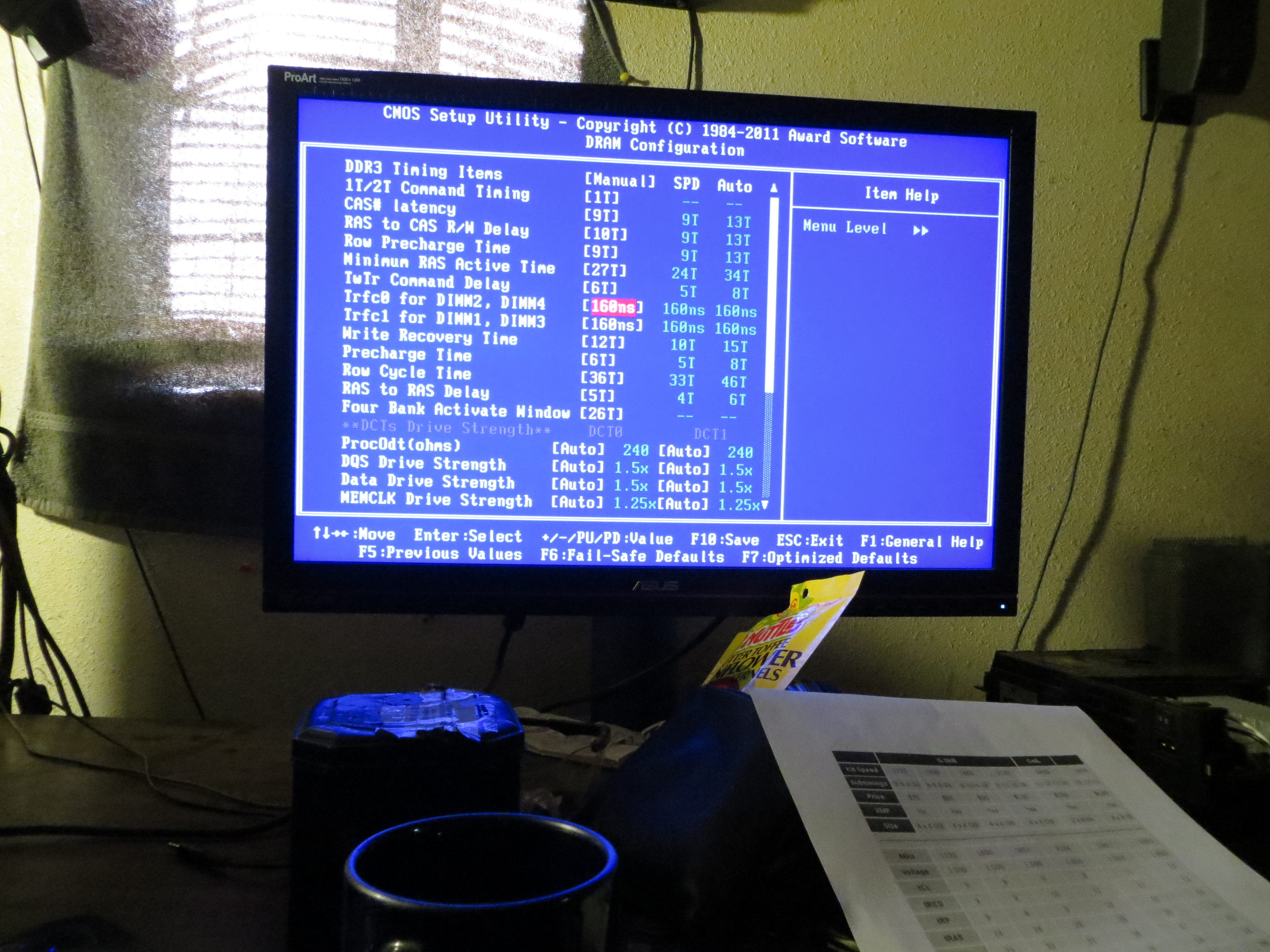

Here are some stable timings for me with 4x4GB at 1866 on my fm1 GA-A75M-UD2H
mem voltage is at 1.52v and 1.2125v (+.075v from auto) for the mem controller.
The hynix chips on my mushkin 2133 set are spec at 1.5v +/- .075v in their datasheet.
The command timing (CR, T, CT, etc.) and the write recovery (tWR) are important things you might try relaxing. Also loosening ras to cas (tRCD) by 1 clk might help
