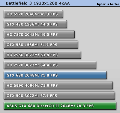

This is from a recent review @ TechPowerUp. W1zzard actually updated his drivers for it. :D
~11.5% @ stock clocks
Now, you mentioned both cards O/C'd. The 680 starts out at higher clocks and who knows exactly what clocks it "boosts" to in BF3, but the 7970 can clock as high as the 680 when O/C'd. I really don't think there will any difference between the 2 O/C'd.

Release drivers. I specifically pointed to the TPU review because they used up to date drivers. They also use a lots of benches. If you read the entire review, there really isn't much difference between the 2 performance wise. Throw in O/C'ing, which Don will do, and the 7970 will likely be a bit faster, actually. The difference, one way or the other, though, won't be noticeable. The 7970 also has the advantages of an extra gig of RAM, which I understand is of limited use, but it's still there should the need arise, and beefier power stage, 6pin+8pin with, I believe, 1 extra vrm stage for the GPU (couldn't find a reference, I'm going from memory. correct me if I'm wrong?), and with Don being an O/C'er, the 7970 offers voltage control, where the reference 680 does not.

AT maximum overclocks they are roughly equal to each other, IMO. At least at 2560 resolution, they're about the same depending on the game. 7970 wins some 680 wins some, the difference is negligible most of the time if they are both oc'ed to their respective maximums.
680 will win bf3 and skyrim, bc2, sr3, dirt 3. 7970 wins witcher 2, all crysis games, metro 2033, alan wake, de: HR. 1300 might be doable on an accelero cooler, but you'd have to up volts and you'd dump a ton of heat in your case. 1200ish is a more realistic expectation if you're using aftermarket cooling....maybe more if you want to up the volts
The hardocp review has a good max OC comparison, also legitreviews / hardwarecanucks has a MSI lightning 7970 review, although the oc is a modest 1070.
