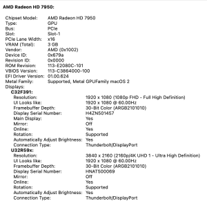

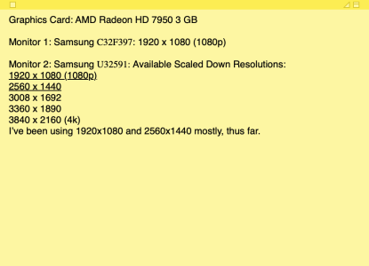

You seem to know a lot about this card and your detailed info was very informative. I just recently bought a Flashed PC 7950 card for my Mid 2012 MacPro. Long story but I'm still in OS 10.10.5 for Audio production and composition reasons. I wanted to be able to run 3 monitors, specifically a bigger flat screen with HDMI for my film scoring gigs. I'm sure this card will allow this configuration but when I installed the card I started experiencing screen freezing with Safari and Chrome. I changed a setting in Chrome I think it was a flag composite setting and Chrome seems to be behaving better, Safari still freezes for a bit and then catches up. Additionally, sometime both monitors that I'm running at the moment go black and they never some back so I have to perform a hard reboot. Any insight you may have regarding this GPU mod I've done would be be great. Thanks so much.

I think you would be better off buying a new Mac than trying to fight this. You're talking about an almost 10 year old GPU, it's probably gone bad.

So I'm guessing your answer is, the card shouldn't be doing this given the OS I'm running and most likely due to the age of the GPU it's probably tired or done. Just want to make sure before I return it. Thanks for your insight, much appreciated.
