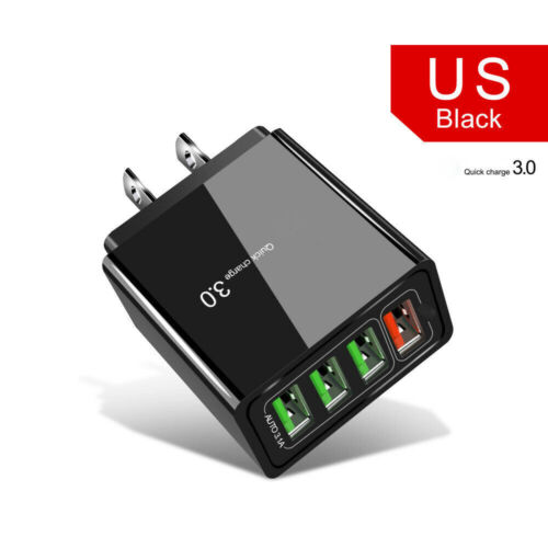

i have 2 phones and a fitbit but only a single port wall charger.
i cant charge both phones at same time and i'm tired of switching out the usb micro-A cable with the fitbit cable.
so i was looking at 3 or 4 port usb wall chargers.
Aukey multi-port wall chargers are EXPENSIVE compared to ebay.
eBay $4.29:
3 regular ports + 1 fast charge port:
the ebay one above says 3.1A.
i need at least 1A since my desktop computer's usb port (500mA) barely charges my phone because i use the phone as a wifi Hotspot.
how much power do you think it actually delivers?

Realistically, you'll probably get more than 1A if you have just one device connected, but less than that if you have more than 1 device plugged in at once.
Of course, you also have to worry about the thing overheating, catching on fire, and/or damaging your device because of poor quality control on those Chinese knockoff chargers. I wouldn't risk it.

Lol that one can only put out 3A @ 5VDC.
See picture 6.
See picture 6.
so .75A each port?
or it'll allow you to draw as many amps as your device can drink and exceed the 3A max? thus why it could melt/burn up?
5V max 3.4A
so 1.13A max each port?
or any combination up to 3.4A and then the built in circuitry wont allow you to draw more than 3.4A max thus preventing a fire?

so .75A each port?
The first one doesn't specify how much each port is limited to but it can only put out 3A total at 5V. Ikea one says max per port is 2.4A but the charger can only put out 3.4A
And I would trust the IKEA rating a bit more than the ebay noname one.
so how does a cheap ebay wall charger catch on fire if the max it'll do is 3A?
or it's lying about the 3A limit and you can draw unlimited thus melting the insulation protecting the wires?
Many different ways, mainly poor component quality and design.
I would never get a charger that does not have a cord. Having to cram everything into form factor that works with receptacles carries compromises.
I'm not an electrical engineer, but I have played with a few voltage regulators. The cheap linear voltage regulators output heat proportional to the current used. Double the current and you double the heat output. Without additional circuitry (at additional cost) to limit how much current is used, the heat output can be quite high. Then put the whole thing into a cheap plastic box which can't dissipate much heat and you see why the regulators burn themselves up.
