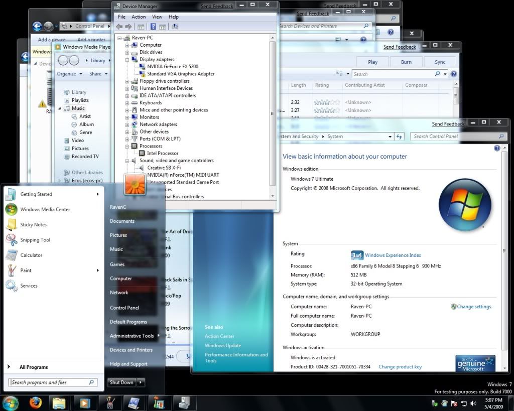

So I installed windows 7 on an old Compaq Presario 5005sr i got from Sears years ago.
Pentium III coppermine 933mhz
512mgs pc133 sdram
Geforce 5200 256mgs pci
X-FI Xtream audio pci
80gb westerdigital hdd
1TB westerdigital external hdd
The computer origianaly had 128mgs of ram, a 60gb hdd, no gfx card and had windows ME.
Windows 7 seems to run kinda slow but it just chugs along with out crashing. More than i can say for winME. 10+ windows open + importing a large library of music an everything worked.
Just real slow. Loaded up World of Warcraft on it, i get about 6fps outside of citys. Windows XP would get about 15fps in the same place. I'll try to get more games to work on it later.
As far as i know, this is below min spec for windows 7. i could be wrong though.
But it still works!
Well at least it dosent use up ALL the ram.

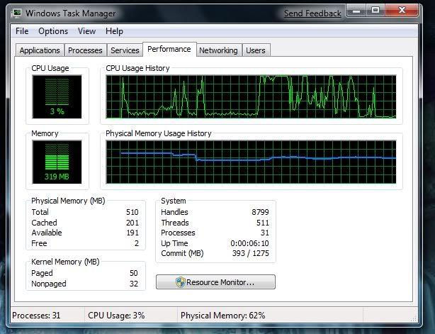

Yes the CPU is a bit slow as far as MHz go. As for the CPU achentecture its way slow. But whats really holding you back is the amount of RAM. You need 1GB but i don't think that board can acomidate that much. Chances are it will max out at 512MB of RAM.
Considering the numbers your memory usage is maxed out. There is only 2mb free so that is pretty much maxed out.

It would work much better with 1GB RAM or more (if your computer support it).
Yeah it looks like it does not use all the memory because the OS it tuned to balance between the actual RAM and the pagefile (Hard Drive emulating RAM).
So in your case it leaves some RAM available but it is using more the pagefile and thus it works slow.
As an Example with 2GB RAM it would use at idle about 800MB to 1GB RAM.
