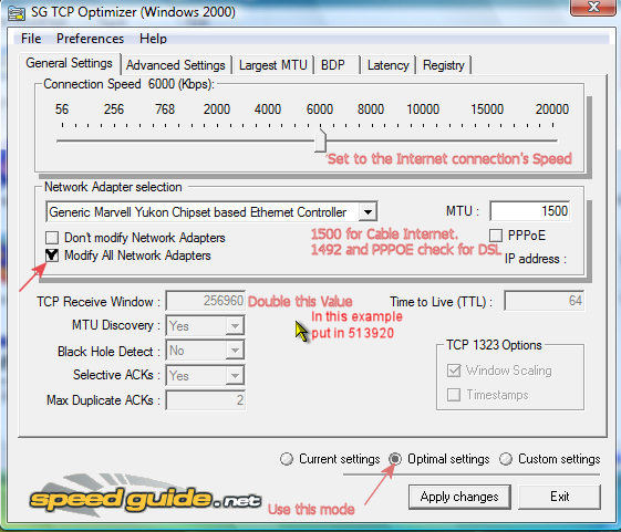

    Try this.
    Download TCPOptimizer, http://www.speedguide.net/downloads.php
    Optimize each computers' TCP/IP according to the Internet connection and double the RCWin.
    [​IMG]
    The optimization works when there is a basic Giga traffic.
    I.e., if One gets only 20 - 30 MB/sec. it will boost the "Speed".
    If the basic Traffic is Not Giga it usually some sort of Hardware issue and it has to be dealt with first.

  10. ingeborgdot
    ingeborgdot Golden Member
    Joined:
    Jan 12, 2005
    Messages:
    1,131
    Likes Received:
    I tried it but nothing changed.
