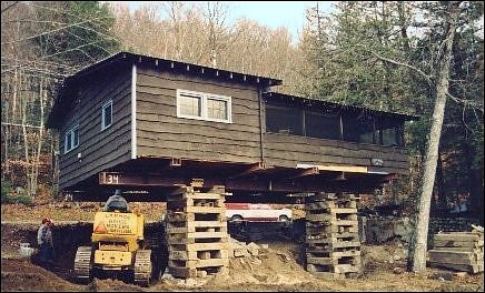

A professional house mover. They will install beams and brace the house properly for the move. Very slowly, of course.
If the house couldn't withstand the move, it wouldn't withstand many storms either.
Example of beams.
