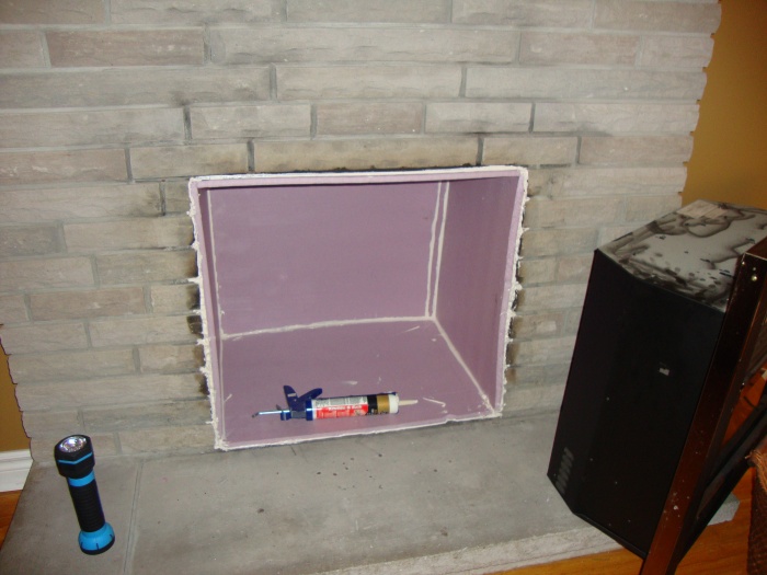

I insulated mine last year, but it's electric. This would probably work for gas too, though a bit more tricky as you can't just pull it out like that.
Yes, that is frost/ice
Obviously this would not work for a real fireplace though. :p

That's the downside of fireplaces, they're kinda cold zones when not being used.
Ya, foam probably doesn't stay non-toxic and whole at normal fireplace temperatures.
