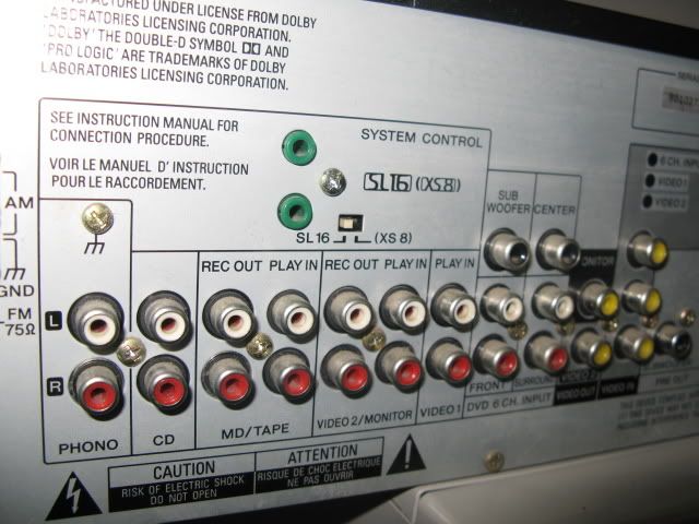

How do I hook up this amp/receiver to my PC ?
Nohr
Jan 6, 2001
7,302
32
101
www.flickr.com
That receiver doesn't have any digital inputs so you'll have to use analog. For stereo you'll just need a 3.5mm to RCA cable. Hook one end to the green speaker jack on the computer and the other to a free red & white RCA input on the receiver.
montypythizzle
Nov 12, 2006
3,698
I think you can hook it up as it is now for 5.1, as long as your onboard supports it. It should have settings in it's control panel for green being center and subwoofer, and the others as microphone as surround and line in as front. IDK if your card has this, and that was just an example. You will need a subwoofer with a low level input and some speakers to go with it to get the 5.1 effect.
Just get 3 of those 3.5mm to RCA cables and it should work, may want to wait for others to answer the question, but I believe that is how it is done.
BTW, the ones I am talking about is the DVD input.
Mar 10, 2005
14,647
it's easy. you'll need 2 things
1/8" STEREO to RCA adaptor (notice i said stereo and not mono)
Stereo RCA cables
1. plug the adaptor into the speaker output on the pc
2. plug the RCA cables into the adaptor
3. are you using a separate cd player? if not, plug the RCA's into CD on the reciever. If you are using a cd player, the use MD/Tape Play In or DVD 6 CH Front.
4. turn the volume way down on the pc, then turn on the reciever. use the radio or cd player or something to find a comfortable listening level.
5. play something on the pc, and gradually bring the volume up on the pc to match the level you heard in #4.
6. in the pc audio controls, move the balance all the way to the left. is the only sound coming from the left speaker? if it's on the right, turn off the reciever and switch the RCAs around.
7. important!!! pc sound levels can be all over the place, so go through everything that makes a sound on your computer with low volume on the reciever, and adjust each program's volume. you don't want to be blown out of the water when you open your email or something.
8. crank up to eleven

Usually integrated sound or a soundcard with 3 stereo jacks can be configured for anything between 2.0 and 5.1 operation by changing the driver / sound utility settings.
Even if he is stuck with stereo for some reason, getting a dedicated soundcard is what I would suggest instead of trying to convert from the digital output.
(That or get a new receiver ;) )

Hey people you guys have all been a great help . Well I tried to hook it up from the dvd side since I already have a 2 Rca to 3.5MM that I happened to have . I have two front (huge speakers) one center and two small surround speakers. It so far only works through the audio output . It sounds pretty dang good for free but I think I need something better :( can anyone recommend some good music listening speakers (music)

If you go into your realtek control area, can you configure what kind of speaker system you have hooked up?
FYI music is generally 2-channel only and thus would only come out the front two speakers unless you have some sort of surround processing happening on the signal either by the sound player, the integrated sound, or the receiver settings.
